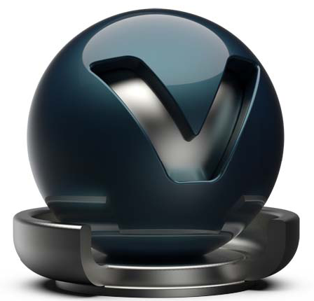

Measured Carpaint
Measured Carpaint
This material type aligns to the measured material. It additionally enables adjusting the refraction index of the scanned material within its properties. Create this through the X-Rite Measured material.
Note:
In 2026.1, to improve the spectral representation during Carpaint spectral raytracing, we added full spectrum support for AxF Carpaint.
Measured Carpaint
  • Measurement - Loads a BTF measurement file.
  • Exposure - Controls the intensity of the measured colors. A value of 1.0 keeps the measured colors unchanged.
  • Fresnel IOR - Sets the index of refraction for the material by showing the amount of rays reflected off versus refracted into the surface.
