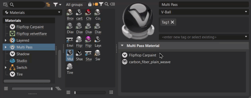

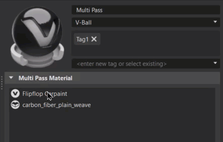

Multi Pass Materials in the Attributes
When a multi pass material is selected, its material variants are listed in the Attributes. However, if they aren't, click the section title.
List of multi pass material variants

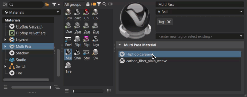

Right-click a material variant of a multi pass material to access the following options:
Select Material icon Select Material (Ctrl+N) - Use for loading the properties of the multi pass material's original material into the Attributes. With a multi pass material selected, right-click one of its material variants and select Select Material to load the original material properties, not those of the material variant.
Select Material option

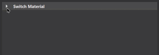

Select Child icon Select Child - Use for loading the properties of a multi pass material child into the Attributes. With a multi pass material selected, right-click one of its material variants and select Select Child to load its properties, instead of those of the parent material.
Select Child option
Notice the change above the tabs. Clicking the parent tab returns to the list of material variants.
Parent tab
Paste icon Paste (Ctrl+V) - Adds the copied material to the multi pass material.
Delete icon Delete (Del) - Deleted the selected material variant from the multi pass material.
Move Up icon Move Up (Ctrl+PgUp) - Moves the selected material variant up in order, switching it with the one previously before it.
Move Down icon Move Down (Ctrl+PgDown) - Moves the selected material variant down in order, switching it with the one previously after it.
