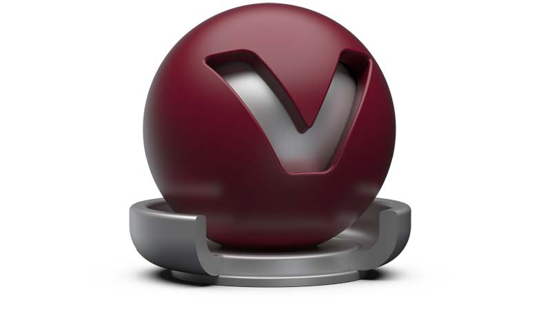

Plastic
Plastic
Plastic is suitable for simulating shiny or glossy surfaces from objects that are made of synthetic materials.
