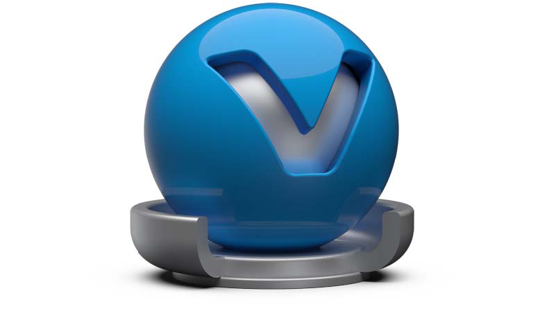

Reflective Plastic
Reflective Plastic
Reflective Plastic is suitable to simulate shiny or glossy surfaces from objects that are made of synthetic materials. It adds the ability to have a mirror image reflection of everything around on its surface.
