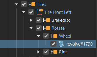

    2. In the Scenegraph, select the wheel geometry.
      Wheel geometry in the Scenegraph

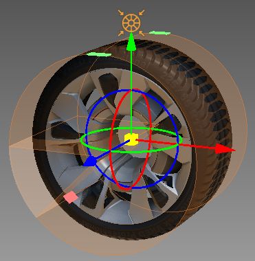

    4. In the Texture Settings section, click Get from Object and set Rotation Axis to Custom.

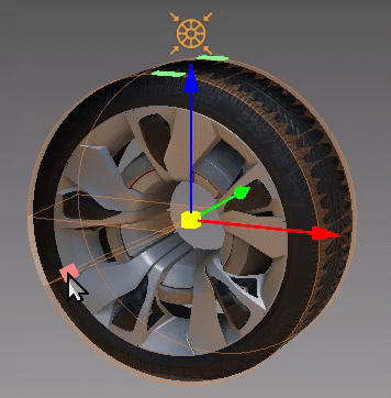

    5. Shift-click and drag the manipulator to edit the texture placement.

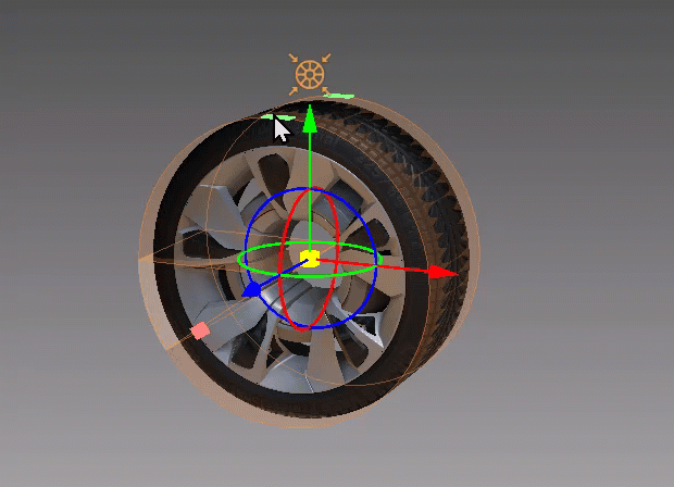

      • To widen the tread, Shift-click and drag the green indicators.
        Widening the tire profile
      • To repeat the tire profile, Shift-click and drag the pink indicators.
        Repeat the tire profile
