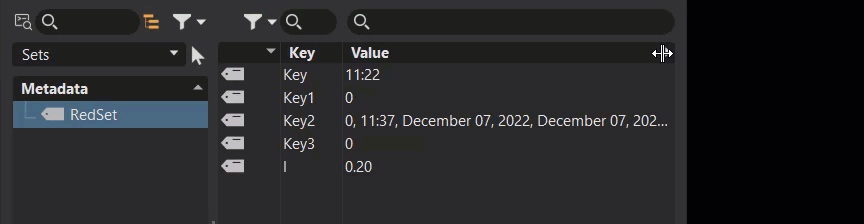

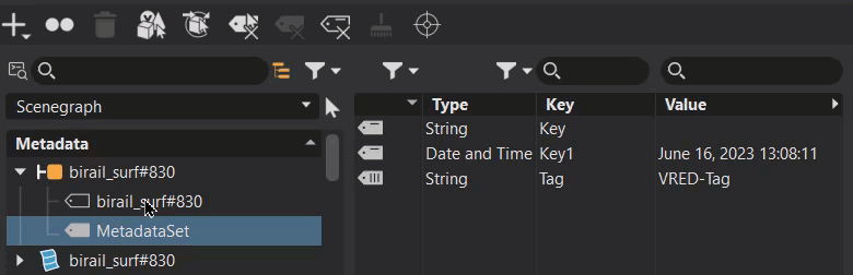

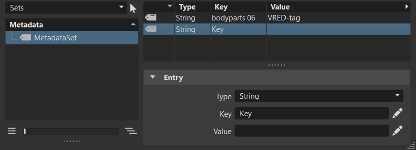

Use Create Entry to define the metadata set with key/value pairs. The key is the keyword or instructions added to the set and the value is the definition of that keyword.
- Select either an object or set in the tree.
- Right-click, select Create Set, and name the set or select Create Entry, choose a type, then enter a key and the value information.

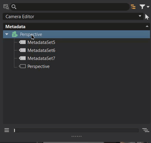

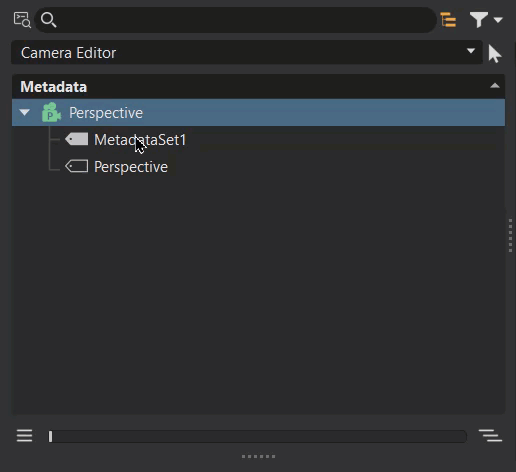

For data prep, use Assign Sets to to help flatten the scenegraph by assigning created metadata sets to specific objects, such as to lights, cameras, a part, or backplate. The metadata sets can be used in place of switches (with deep hierarchies) for variant switching via scripts. The reduced scenegraph complexity results in significantly increased performance.
Select Edit > Assign Sets to and choose where the sets are assigned, from your last selection, any selected nodes, materials, cameras, lights, or sceneplates.
You can also just drag and drop metadata sets onto objects in the List Tree.

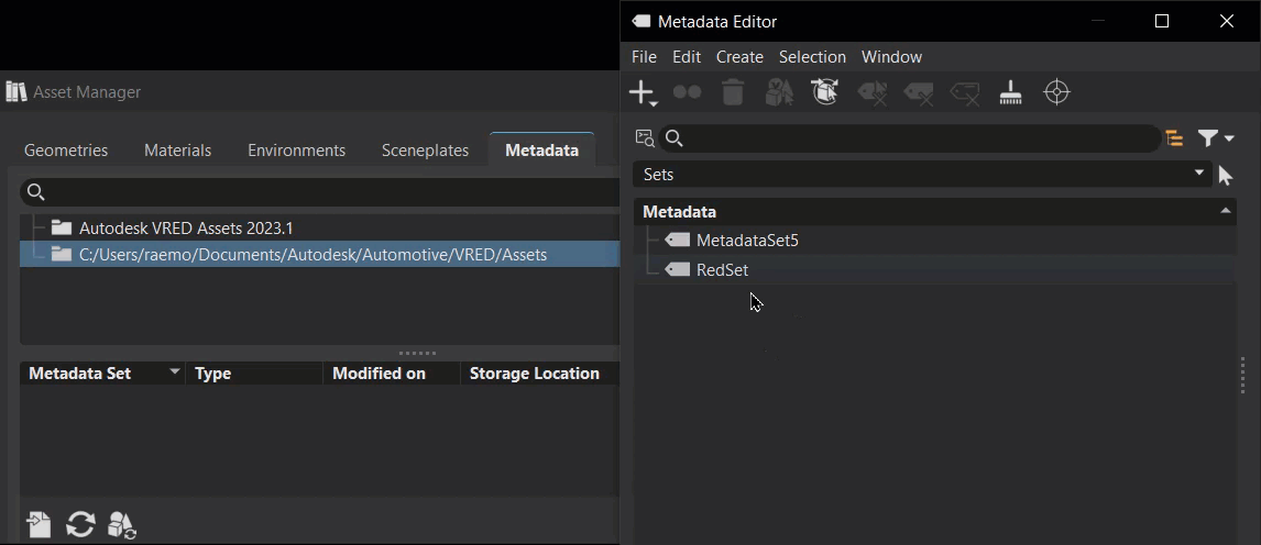

Creating Asset Metadata Sets
Use metadata sets from the Metadata Editor to add metadata to assets. Drag sets into the Asset Manager's Metadata tab. Doing this changes the tag in the Metadata Editor to
Editing and Reloading Asset Metadata Sets
Use the Asset Manager to make changes to a metadata set by editing its .json file, then reloading it, to update the information in VRED.
- To change an asset's metadata, in the Asset Manager Metadata tab, right-click the metadata file and select Open in Explorer.
- Edit the .json file in a text editor and save your changes.
- In the Asset Manager Metadata tab, select the changed asset set in the list.
- Click
, Yes to replace the asset in your scene, then

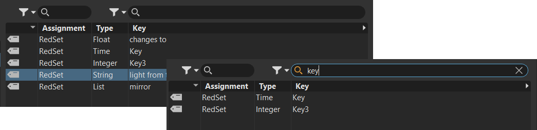

Searching Table Columns
Enter simple search term in the
field for the Assignment, Key, and Value columns. When the column is displaying search results, the
changes to
To clear a search, either click the X next to the search term or delete the content in the search field.
