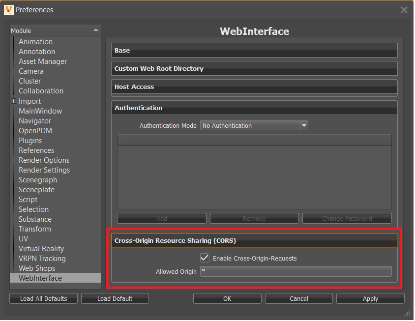

A Cross-Origin Resource Sharing (CORS) section with the following options was added to the WebInterface preferences. Use the HTTP Headers for CORS and How This Works content to set this up and understand how it works.
CORS in the WebInterface prefs
Enable Cross-Origin-Requests
Enables resources on a webpage to be requested from another domain outside the domain from which the first resource was served.
Allowed Origin
Only available when Enable Cross-Origin Requests is enabled.
Enter the URL domain to be displayed by cross-origin request sharing in the Web Interface.
