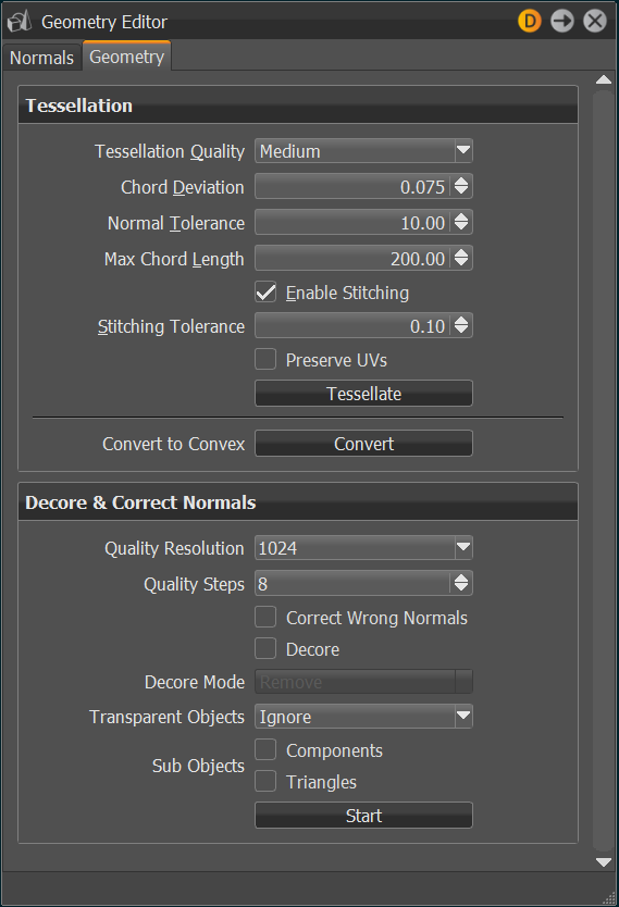

Changes have been made to the previously named Decore section, which is now the Decore and Correct Normals section. It has been decoupled, so all functions are available in the Python v2 API.
In Decore and Correct Normals, access geometry normals (or use vrdGeometryNode, set/getNormals), set the correct face normals (or use vrDecoreService), and select your decore settings.
The following were added to the Geometry Editor:
Decore - Enables the decoring and the parameters for defining this behavior.
Decore Mode - Defines the action to be taken, when geometry is determined to be inside another and non-visible. Choose from the following:
Transparent Objects - Determines how objects behind transparent objects are handled. Select from the following:
Ignore - Transparent objects are ignored (i.e., they do not occlude other objects and they are not occluded by other objects). (Fastest mode)
Treat as Transparent - Transparent objects will not occlude other objects, but they can be occluded by non-transparent objects. (Slower, but most accurate mode)
Treat as Opaque - No special handling for transparent objects, they are treated as opaque and will occlude others. This is the previous version's VRED behavior.
Sub Objects - Determines how sub-objects are factored in when decoring. When neither is enabled, sub-objects are not changed and decoring only happens at the object level.
- Components - Works on the component level for shells.
- Triangles - Works on the triangle/polygon level for meshes.
