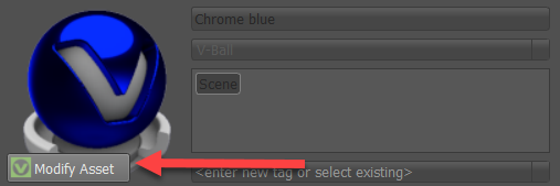

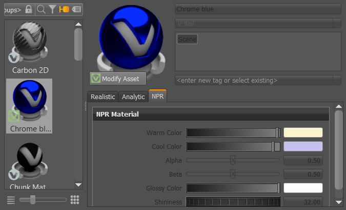

  • Modify Asset icon Modify - Makes it possible to change the selected asset, making the properties editable.
    Before After
    Attributes uneditable Attributes editable
    Tip:
    You can also click the Modify Asset button below the material preview.
    Modify Asset button

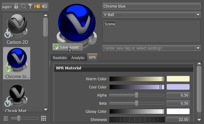

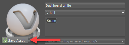

  • Save in Asset Manager icon Save in Asset Manager - Saves the modified selected asset within the Asset Manager. The Attributes is greyed out, once saved, and the Save Asset button reverts back to Modify Asset.
    Before After
    Attributes editable Attributes uneditable
    Tip:
    You can also click the Save Asset button below the material preview.
    Save Asset button

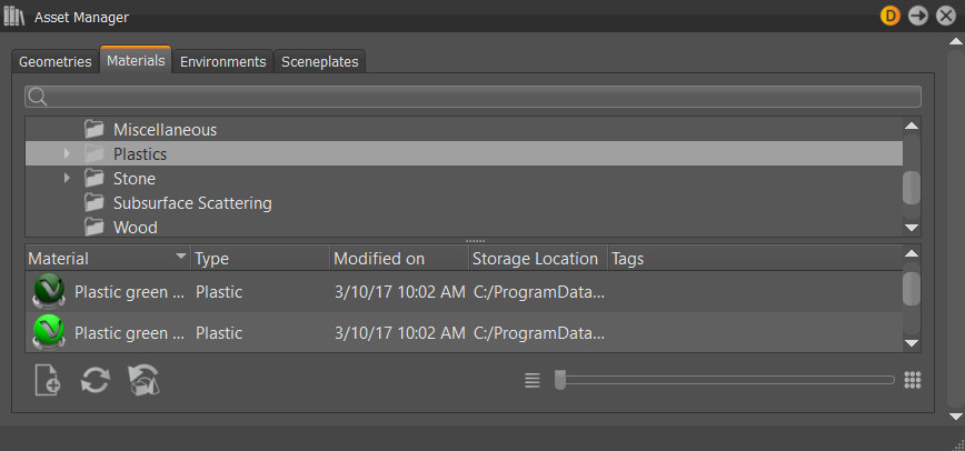

  • Find in Asset Manager icon Find in Asset Manager - Opens the Asset Manager and selects the corresponding folder within the file browser tree inside the Asset Manager's Materials tab.

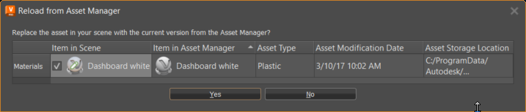

  • Reload from Asset Manager icon Reload from Asset Manager - Opens the Reload from Asset Manager dialog for replacing the asset in your scene with the current version from the Asset Manager. This ensures you're using the correct version of the asset.

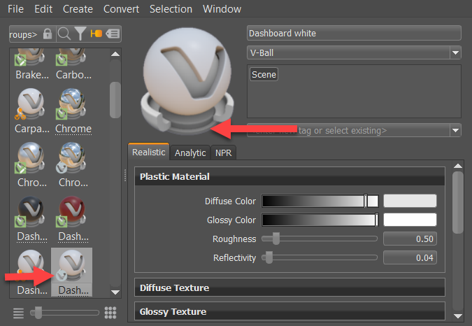

  • Remove Link icon Remove Link - Breaks the link from the node of the selected asset to the Asset Manager. The material is no longer a material asset, as seen by its icon General TruLight icon and the absence of the Modify Asset button.
    Remove Link Attributes changes

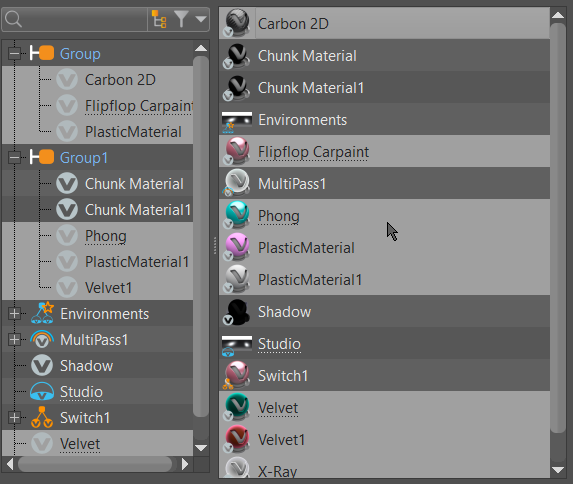

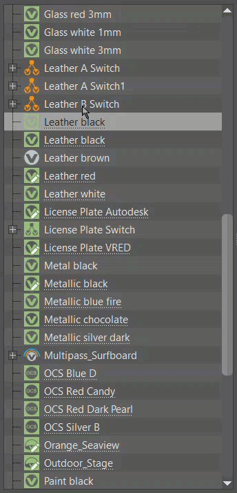

  • Select all Occurances icon Select all Occurances - Selects all occurances of the selected underlined material, highlighting the parent blue and expanding all nodes to find where a material is used. Now, with one or more materials selected, use Select all Occurrences to select all examples of its or their use.
    Select all Occurances example

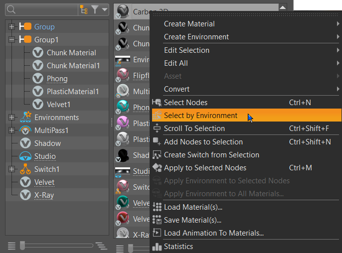

  • Select by Environment icon Select by Environment - Selects all materials with the same environment as the selected material in the Material Grpah or Group Preview. Use it when there different are environments used for different materials and you want to select all materials assigned to a specific environment.
    When one or more environments or environment switches is selected with this option, all materials in the Material Editor with this environment assignment are also selected. If no materials have that environment assignment, nothing is selected.
    With a material selected, right-click and choose Select by Environment or from the menu bar, choose Selection > Select by Environment. If no materials have that environment assignment, nothing is selected.
    Selecting Select by Environment
