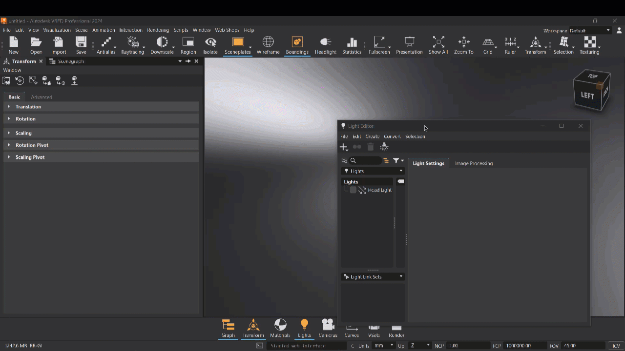

We've introduced a new docking behavior, which is the same as what is used in Alias. When docking a floating window, icons appear as you near the UI, which are used to indicate where the window will be docked. The window automatically resizes to the length of the docked side. Modules can be docked as a stacked or tabbed group.

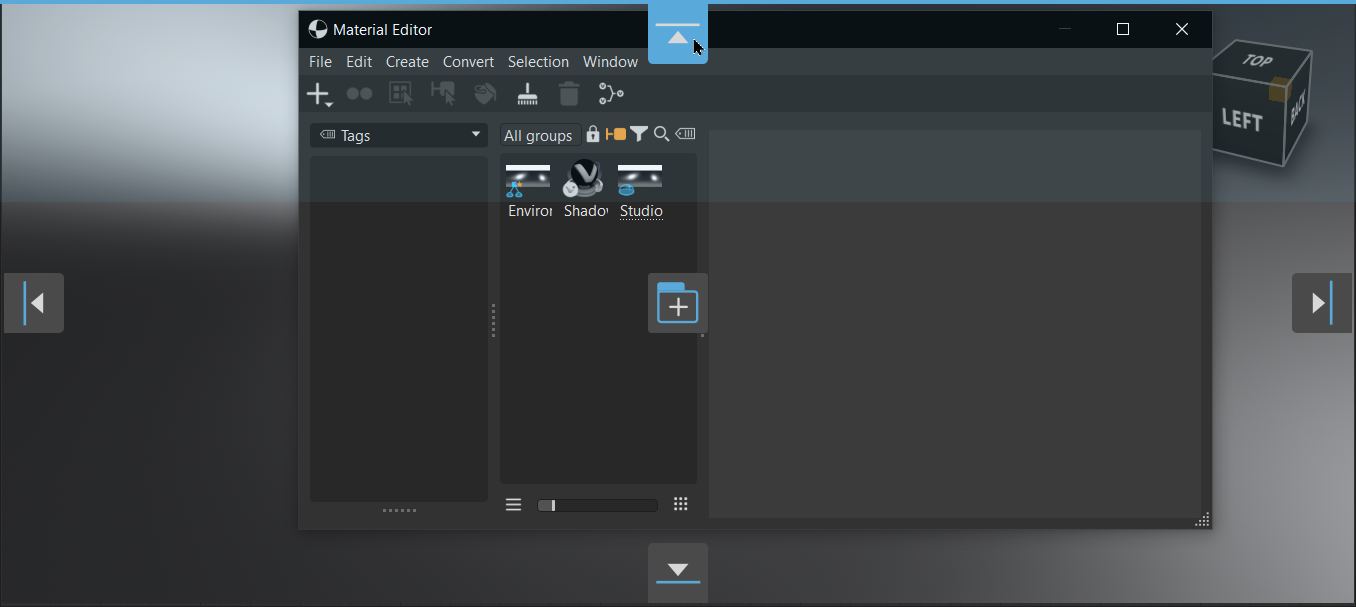

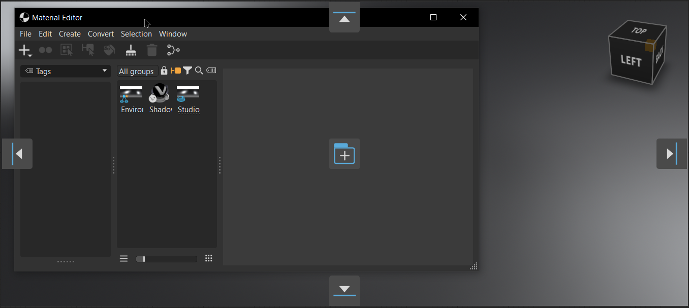

    Blue icons appear, one for each side of the app and another in the middle (Dock Grouped Modules) for grouping modules together.
    Blue icons will appear
  2. Hover over an icon until highlighted, then release your mouse button to dock the module to that side of the UI.

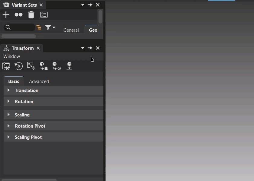

  • To dock modules as a stacked group, press and hold the Shift key, as you LMB-drag the module over the side icon where the other module is docked, then release your mouse.

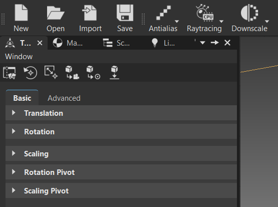

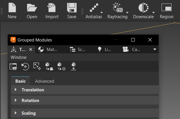

  • To dock modules into a tabbed group, press and hold the Shift key, as you LMB-drag the module over Dock Grouped Modules, then release your mouse. A tab is created and added to the end of the group.
    Window with module tabs along the top

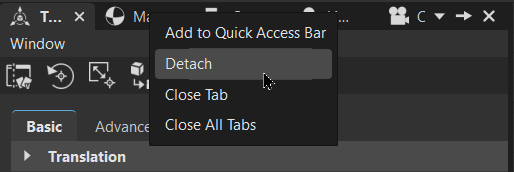

  • To detach a module from a tabbed group, right-click a module's tab and select Detach.
    Detach

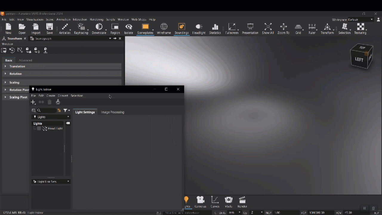

  • To detach a tabbed group of modules, click Undock arrow icon.
    Before After
    Before group Detached group
  • To detach a module from a stacked group, click Undock arrow icon.
Undocking a module from the group
