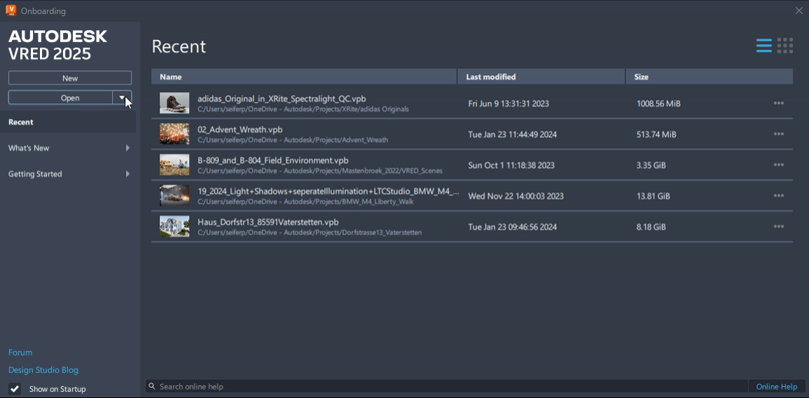

Onboarding

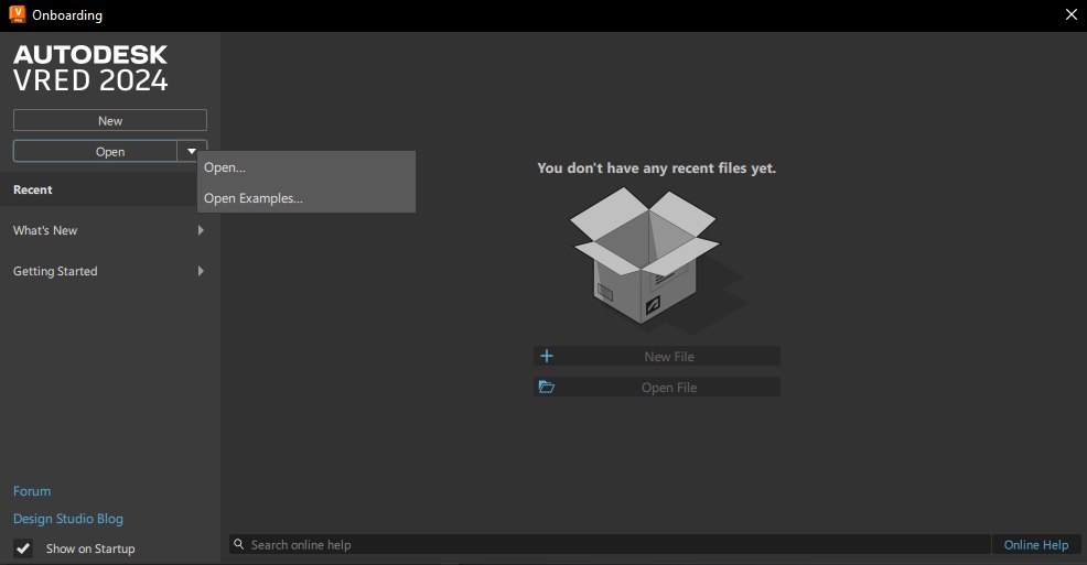

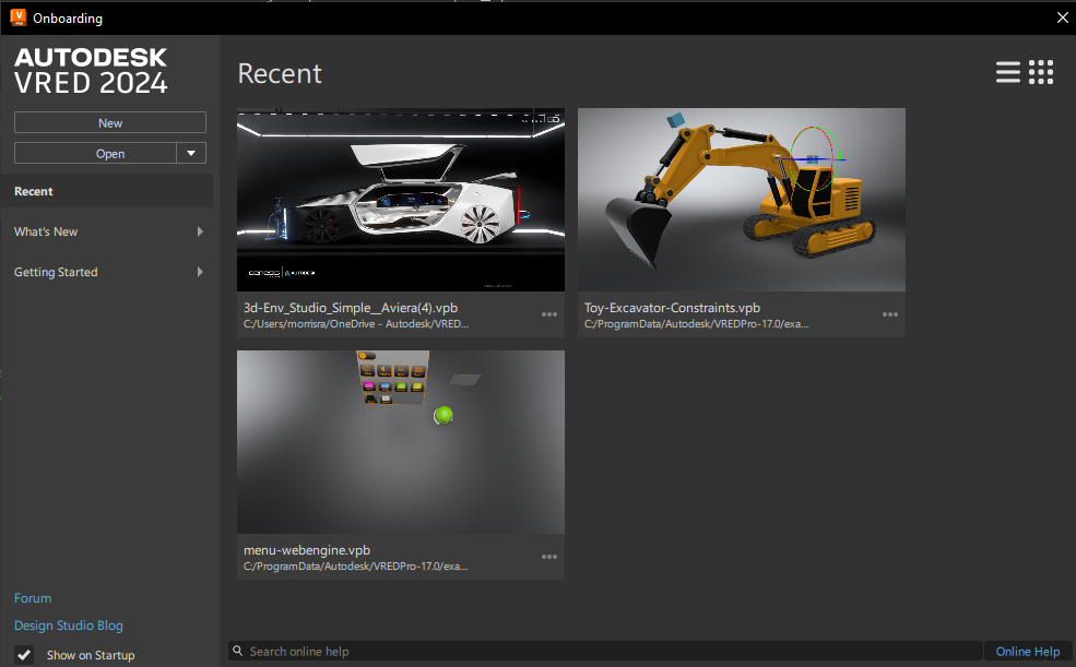

In 2025, we've added Open Examples to Open button for opening sample projects, as well as a way to change how recent files are displayed. For first time VRED users, we added New File and Open File options to the recent screen.
Open button options
Open Examples
The Open button has changed to include a dropdown menu containing the following options:
Open button options
  • Open - Opens a specified scene in VRED amd closes the onboarding dialog.
  • Open Examples - Opens the VRED example folder containing sample projects showing how to set up simple constraints, Python scripts, tracking, touch sensors, VR hands, and more. Double-click a file to open it in VRED and begin working.
When opening VRED for the first time, there are no recent files to list; therefore, you are presented with these options:
  • New File - Creates a new scene file with four camera views and a default environment, after the existing scene is saved or destroyed.
  • Open File - Opens only VRED files, such as .vpb and .vpe. If you want to load other file types into VRED, use File > Import or File > Import Scene Data.

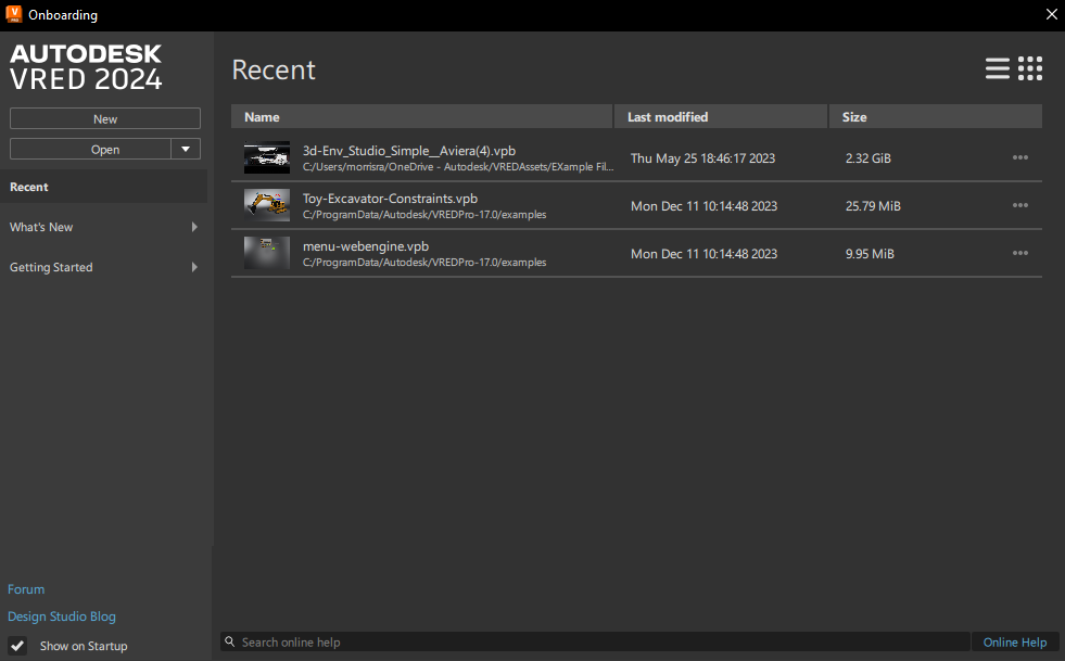

List and Tile View
We added these options to change how recent files are displayed.
  • Click List icon in the Onboarding to view your recent files as a list.
    List view
  • Click Tile icon in the Onboarding to view your recent files as larger tiled images.
    Tile view

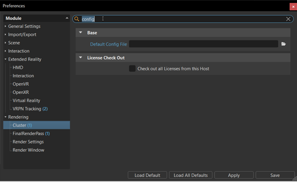

New in Preferences

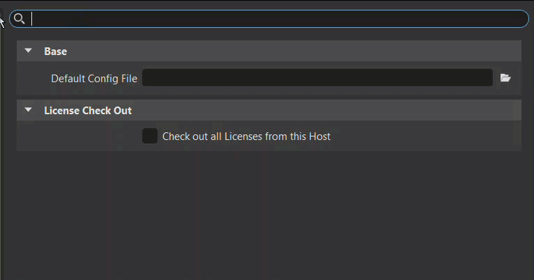

We've reorganized the tree view along the left, updated the layout, added a search field at the top to quickly and easily find a specific preference, and made some changes to the buttons along the bottom.
New Categories
references module
The tree view to the side has been reorganized into six main categories:
  • General Settings - Find color management, copy/paste, device, interaction, navigation, OpenPDM, plugins, script, search, selection, web interface, and web shop preferences.
  • Import/Export - Find cube image, file option, file type, and tessellation import and export preferences.
  • Scene - Find animation, asset, bake, camera, material, metadata, references, Scenegraph, and UV preferences.
  • Interaction - Find annotation and collaboration preferences.
  • Extended Reality - Find HMD and an assortment of different VR and MR preferences.
  • Rendering - Find cluster, final renderpass, render settings, and render window preferences.

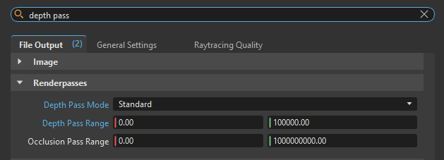

In the Search field to the right, once there are two characters, VRED starts to generate a list of search results. The matching part in each search result is highlighted. Click an entry to load the module preferences, with matches highlighted blue. If only one module matches the search, it is displayed.
Search field example
For modules with multiple tabs, the number of matches highlighted blue appears next to the tab name.
tabs with searches example
When a search is performed, the tree view expands, displaying the number of search hits next to modules containing matches. Click one of these to display that module's preferences, with matches highlighted blue.
Button Changes
These are the changes made to the buttons along the bottom:
  • We removed the Cancel button. Now, to close the Preferences window without saving any changes, click the x.
  • We replaced OK with Save. To save changes made within the Preferences window and use them as the default future values and behavior, click Save.

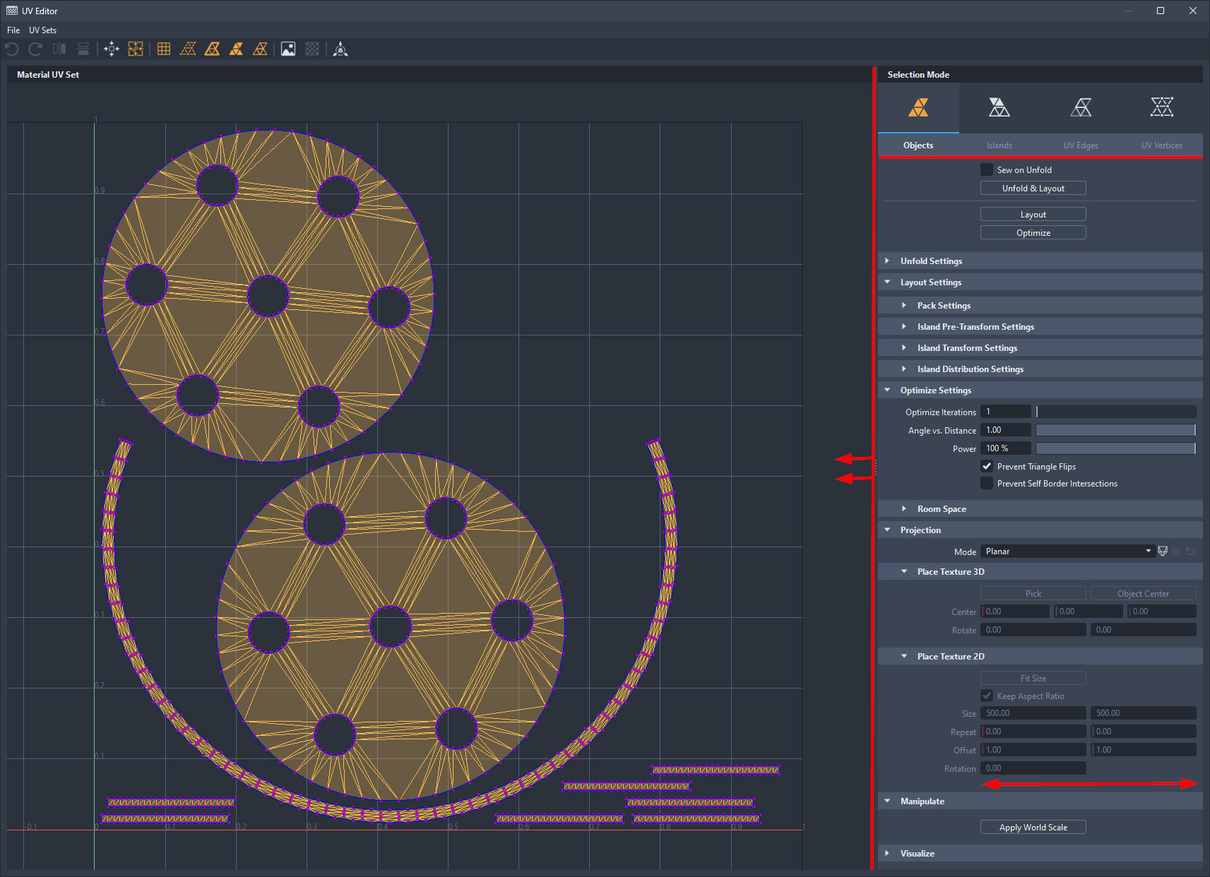

UV Editor Layout
UV Editor changes
We've improved the layout and dynamic responsiveness of the UV Editor. All X, Y, Z input fields are horizontally aligned and the width of the tool panel to the right can easily be resized.

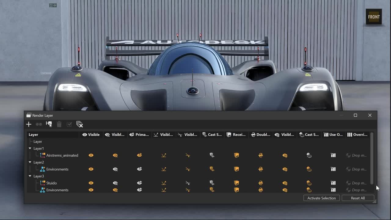

Render Layer UI

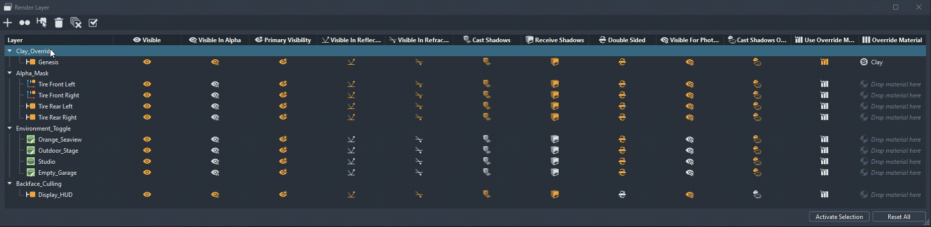

We've made changes to the layout and added some functionality of the Render Layer module.
Image of the updated Render Layer module
  • When there is no assigned overflow material and the module is extended, "Drop Material here" now appears in the once blank cell. However, when the module is reduced in width, a greyed out material ball replaces this message.
  • When there are override materials, they are now represented with the icon of their respective material type.
  • When the module is extended, column labels and icons are displayed. However, when the module is reduced in width, these labels, as well as all checkboxes, are replaced with icons. The module is still readable, yet this reduced width allows for better integration and docking into the overall layout.
  • When renaming a layer, single click the name to make it editable.
Note:
We have not decoupled the Render Layer module itself; therefore, Python access remains limited.

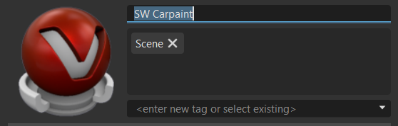

Line Edit
Single line text input field
When you LMB-click a single line text input field in the Attributes, it is now editable like that of value input fields. The entire text is selected with a single click, which is handy for renaming a material Name field.
Note that multi-line text input fields, such as the description of annotations or the Text field in frontplates, did not change and behave the same as before.

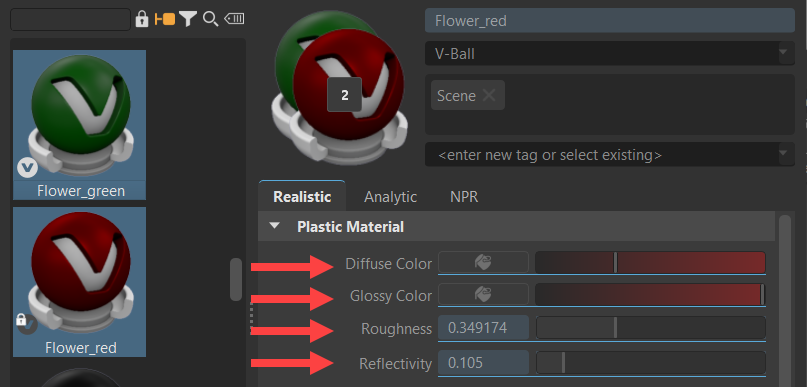

Multi-selection and Locked Values
Image of multi-selection with different locked values highlighted
During multi-selection, it is now possible to identify selected locked options with different values that cannot be modified, as they are now underlined and tinted blue.
