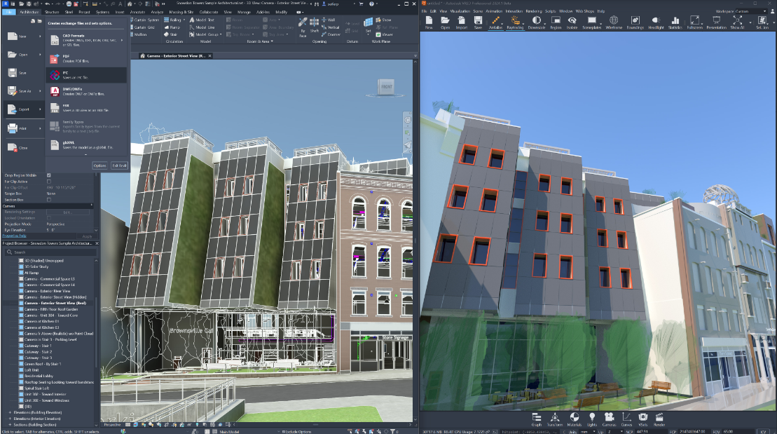

The second file format is IFC (Industry Foundation Classes). It is an industry standard that can include building and civil infrastructure data. IFC is used in the architectural area and made for cross-platform workflows for many different teams, like on a BIM project. This means you can now easily bring Revit data into VRED, via the IFC format. This gives you much better results compared to exporting an Autodesk Revit file to Autodesk FBX. Plus, you can load additional information like materials and metadata.

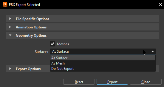

For the Autodesk FBX file format, in the the Geometry Options section, you can convert NURBS surfaces to mesh geometry on export, without changing the current scene structure. You can also remove certain features from the scene.

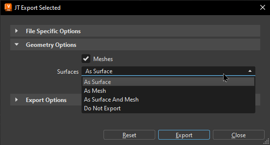

For the JT file format, in the the Geometry Options section, you can export NURBS surfaces either as surfaces or convert them to mesh geometry on export. If you want to keep the NURBS data and an additional mesh representation, this is also possible.
Note:VRED scenes exported as JT will lose all metadata stored on geometry. JT only allows metadata to be stored at a group level. Therefore, when an Autodesk VRED file with metadata stored on geometry is exported as (Siemens Jupiter Tessellation) JT, then reimported into Autodesk VRED, the file will be different, as metadata gets lost if stored on geometry level.

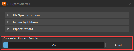

Once exporting begins, a progress bar appears, indicating where in the exporting process things are. Use Abort at any time to cancel the process.

The file format selected will determine the options in the Export Selected dialog. See Export Selected for descriptions of each.
- Select the content to be exported in the Scenegraph.
 - In the Menu Bar, select File > Export Selected.
 - In the Export Selected As dialog, navigate to a location, name the file, click Save as type and select a file format, then click Save.
 - In the Export Selected dialog, set any custom options.
 - Click Export.

IFC Import
In general, IFC is a standardized, digital description of the built environment, including buildings and civil infrastructure. It is an open, international standard, meant to be vendor-neutral, or agnostic, and usable across a wide range of hardware devices, software platforms, and interfaces for many different use cases. The IFC schema specification is the primary technical deliverable of buildingSMART International to fulfill its goal to promote openBIM®. Today, IFC is typically used in the AEC space to exchange information from one party to another for a specific business transaction.
When importing an IFC file, expect measurements, materials and correct naming of the materials, NURBs, node naming conventions, and metadata to all be included. An imported IFC model will be individual surfaces, not one large mesh.
| Revit to VRED file exchange using the IFC file format |
