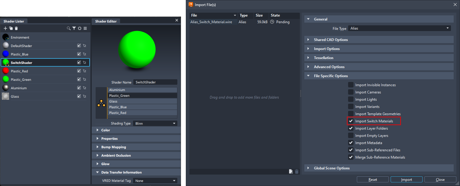

Import Switch Materials
For users importing Autodesk Alias WIRE files with switch materials, we've added Import Switch Materials to the Import File(s) dialog, as well as to the preferences. It enables an Alias switch shader to be imported as a switch material. However, when disabled, only the active shader in the Alias switch shader is imported, eliminating the import of all other shaders from the switch.
The Import Switch Materials preference, found in Edit > Preferences > Import/Export > File Type > Alias, sets the default behavior for users importing Autodesk Alias WIRE files containing Alias switch shaders.

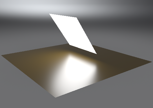

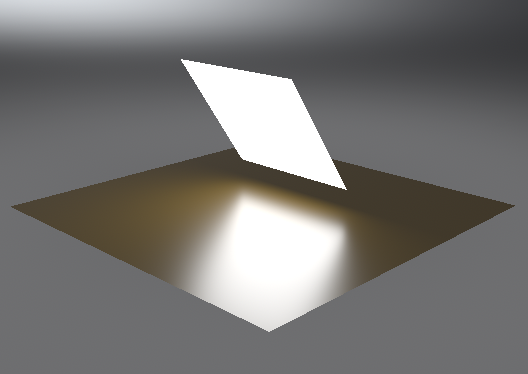

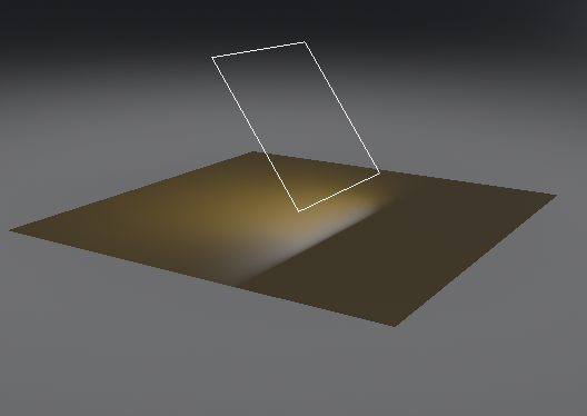

One-sided Area Lights
Area lights before VRED 2025 were two-sided, meaning one side was illuminated (A-side), while the other was opaque (B-side).
| 2024 A-side | 2024 B-side |

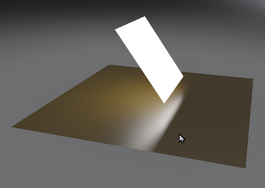

In VRED 2025, we made the non-illuminated side transparent and added a wireframe outline. Now, when a camera is facing this side, the light can be found.
| 2025 A-side | 2025 B-side Wireframe |

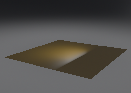

Since area lights now have a wireframe visualization, you may choose to hide this. Use Show Light, previously called Display Light, found in the Light Editor > Light Settings > Visualization section, to display or hide the wireframe.
| Show Light Enabled | Show Light Disabled |

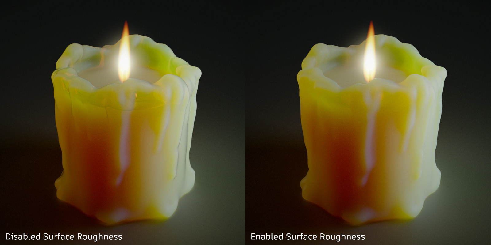

Surface Roughness for Subsurface Scattering
To enable the roughness of a material to affect the way light scatters into or out of a volume, we introduced Use Surface Roughness to the Subsurface Scattering section of the Material Editor. The effect created by this is typically observed with organic materials, such as beeswax, skin, or leaves.

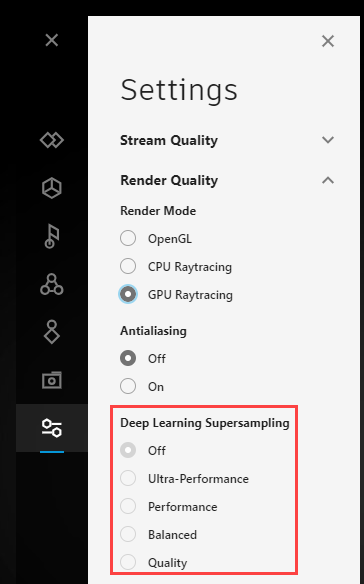

DLSS
For the Streaming App, we've added DLSS. In Settings
, once Render Quality > Render Mode > GPU Raytracing is enabled, the DLSS options are available. Use DLSS to upscale and antialias a rendered image with little performance impact and potentially better render performance, taking a lower resolution image and producing an image that looks higher resolution from it.
Select from these options:
Off - Turns DLSS off and image detail is not altered.
Ultra-Performance - Renders the scene at 1/3 the original resolution and is intended for 8K displays.
Performance - Renders the scene at 50% of the original resolution.
Balanced - Renders the scene at 58% of the original resolution.
Quality - Renders the scene at 66.6% of the original resolution.
We added isDLSSSupported() to vrOSGWidget as a DLSS option for the Streaming App.
For Windows users to use DLSS-RR, you will need the NVIDIA driver v.537.13; otherwise, VRED will default to the DLSS from version 2024.1.
For Linux users to use DLSS-RR, you will need the NVIDIA driver v.535.104; otherwise, VRED will default to the DLSS from version 2024.1.

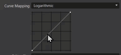

Logarithmic LUT Mapping
We added logarithmic LUT mapping for custom camera response curve. Use a 3D Lookup Table for post-processing color correction to get more sophisticated color transformations.
Curve Mapping - Only available using the Physical Camera tonemapper and Custom Response Curve sensor response. Sets the mapping of input values to the sensor response curve lookup table.
Linear (Legacy option) - Clamps the HDR rendering results to the 0 to 1 range, as input to the lookup table.
Logarithmic - Uses the -12.473930 to 12.56068812 range of the log2 of the HDR rendering results, as input to the lookup table. This allows for 25 stops of dynamic range.
