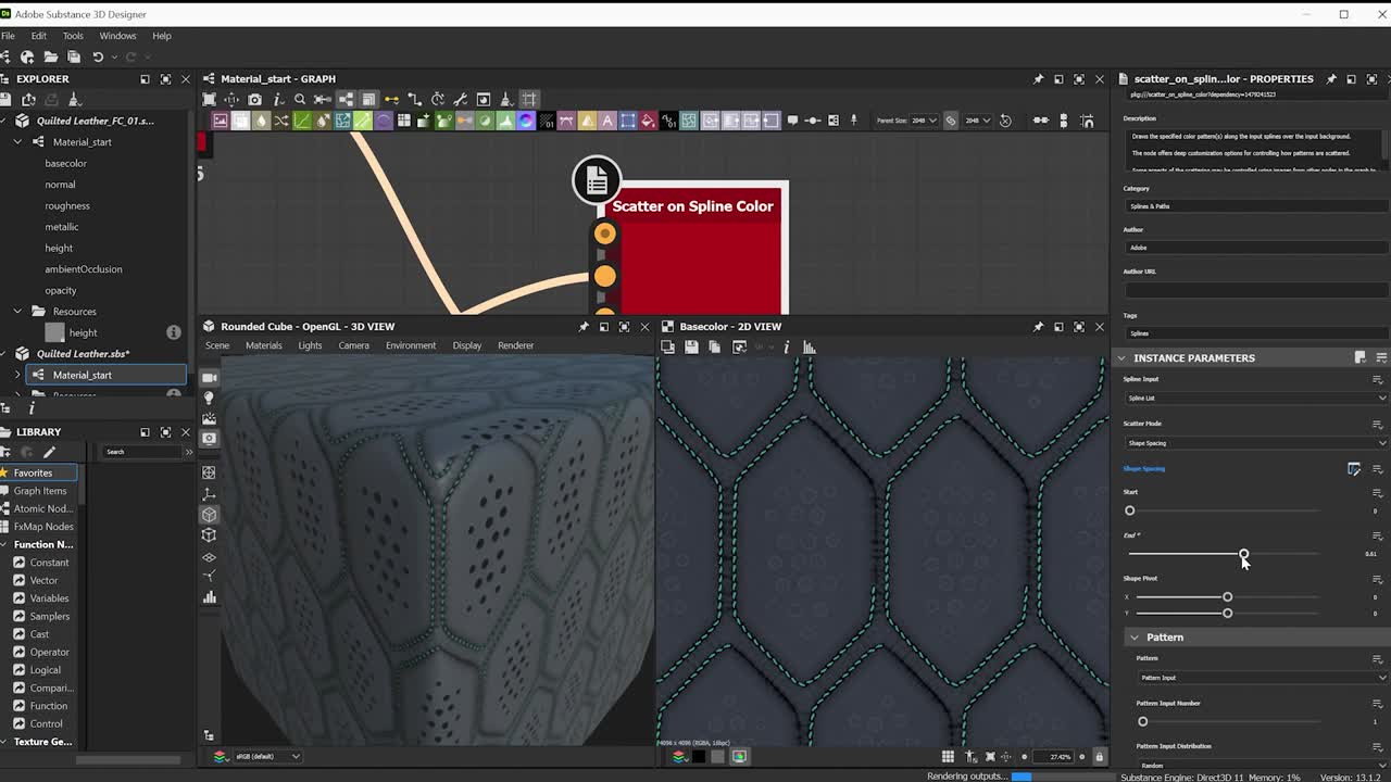

Video captions: Another third-party update is the new Substance SDK, which we implemented to support the latest Substance node types, such as splines scatter nodes for example, like this one, which generates stitches following a path around the embossed patterning. And, I can easily change the complete inputs for it. This gives you so much more flexibility in your CMF workflow.

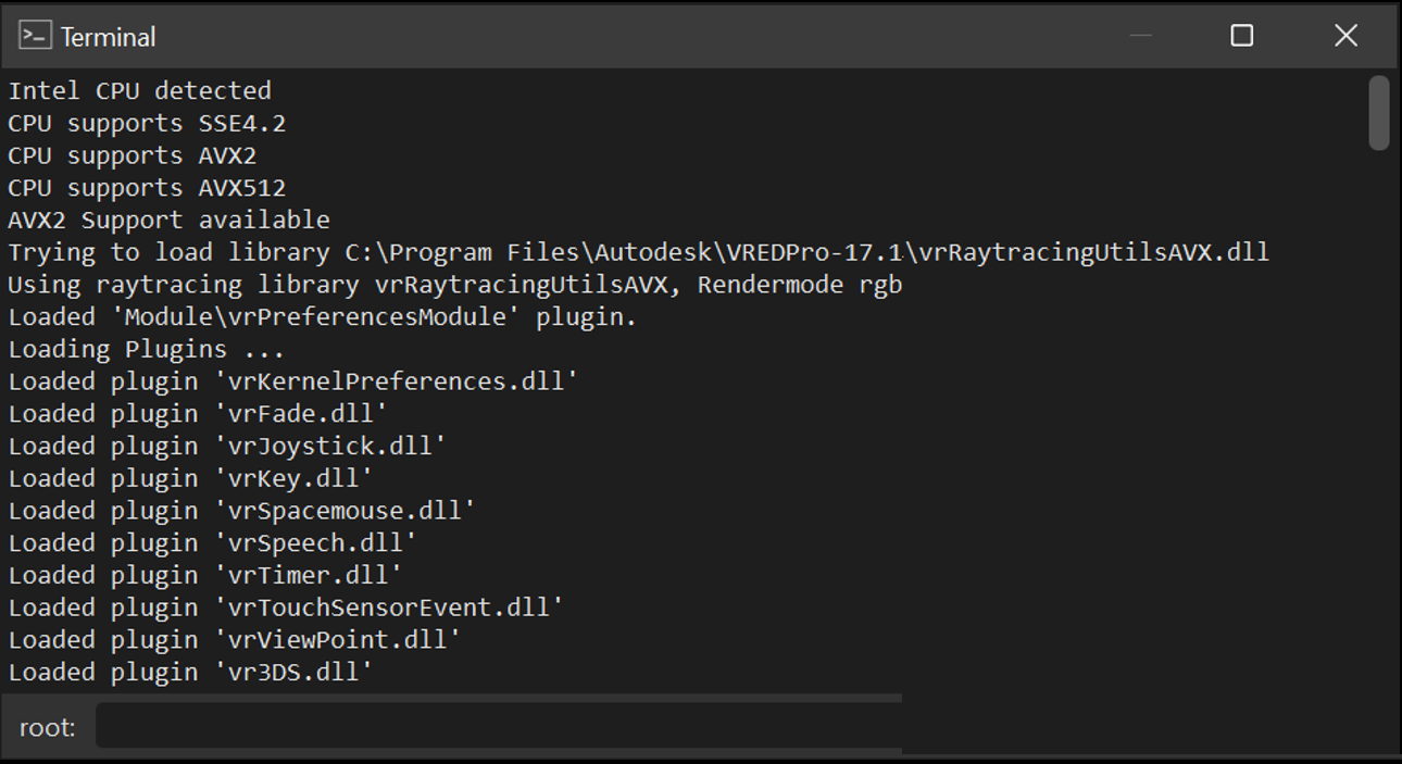

Log Levels
We have exposed vrLogService to add a log level to a Python request. Choose from:
  • info(message, context): This is the least restrictive. Everything (info, warnings, and errors) is displayed.
  • warning(message, context): This is medium restrictive. Only warnings and errors are displayed.
  • error(message, context): This is the most restrictive. Only errors are displayed.
vrLogService

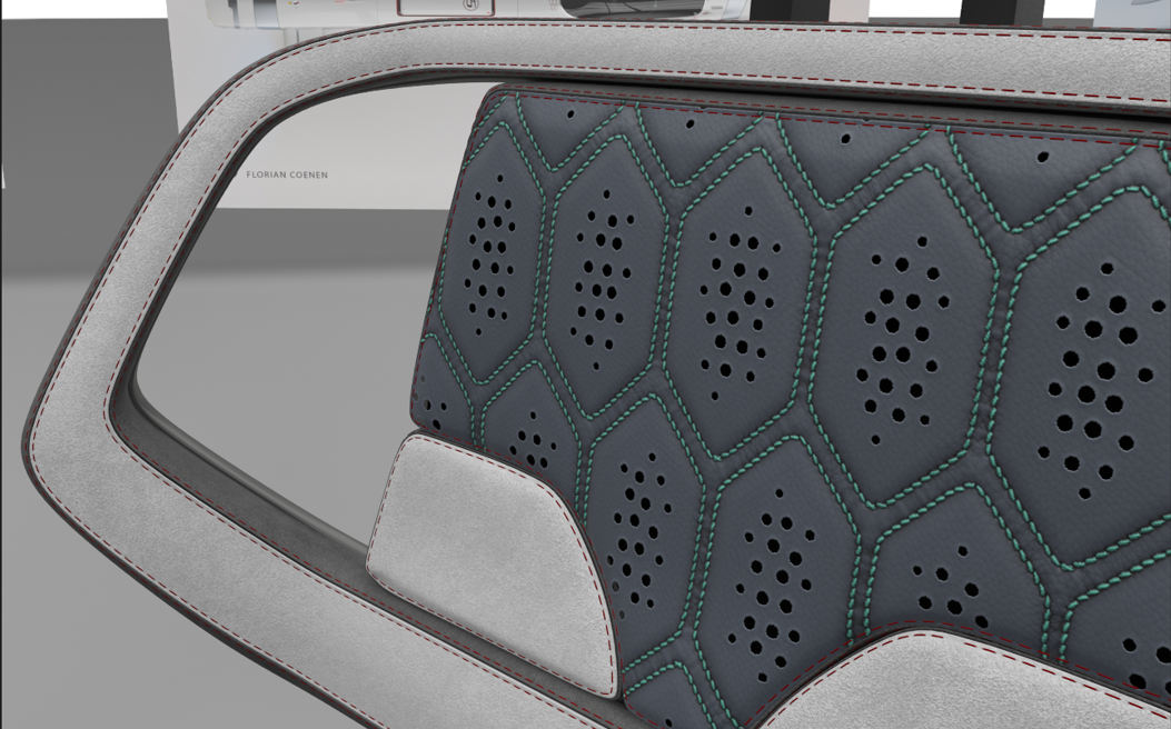

  • Updated the Substance SDK to version 9.1.2 to support newer Substance node types such as Spline, Spline Scatter, and Crop Node. Use it for generating stitches following a path around the embossed patterning. Easily change the complete inputs. This can give you much more flexibility in your CMF workflow.

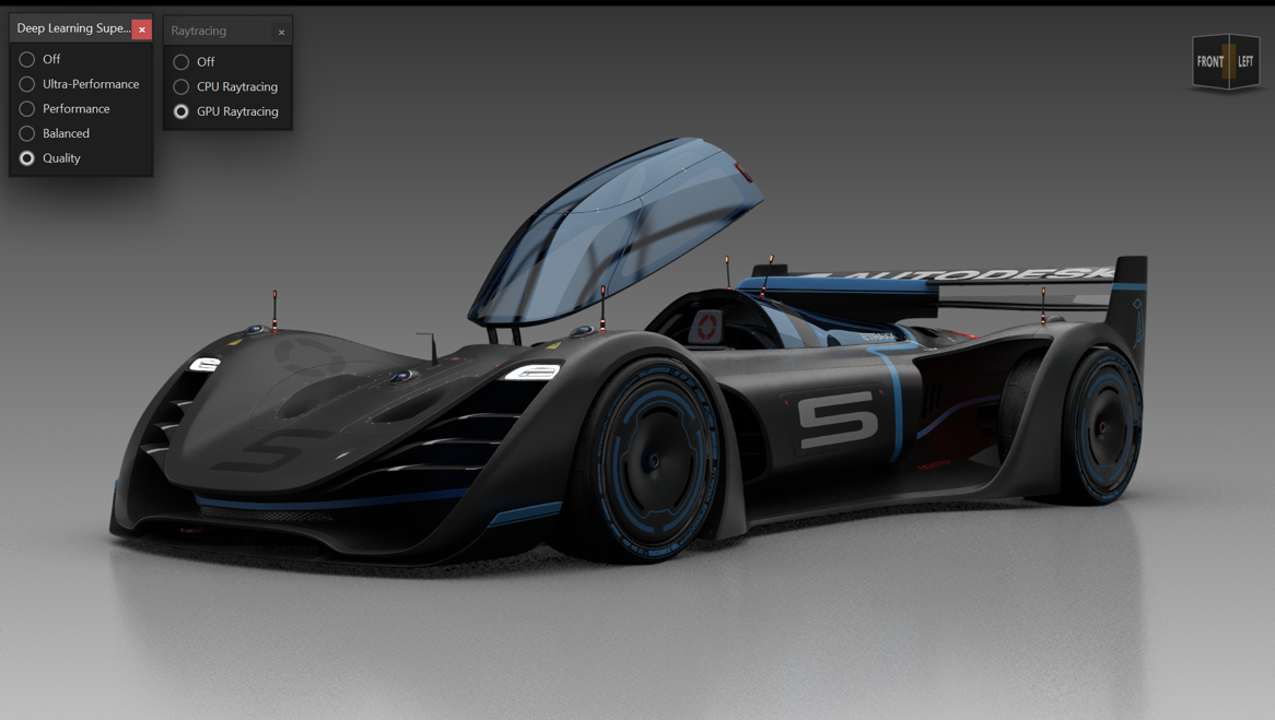

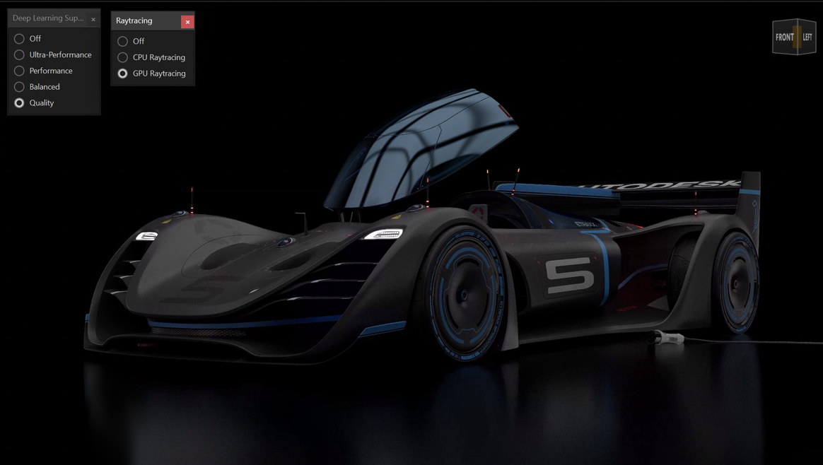

  • Updated the DLSS to version 3.7 for alpha channel support for backplates or mixed reality when raytracing.
2025 2025.1
Black alpha gray gradient alpha

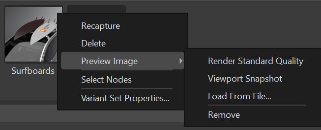

Remove Preview
We added Remove to the Variant Sets context menu to delete variant set thumbnail preview. Either select a preview from the tree or in the Variant Set Simple View Mode, right-click, and select Preview Image > Remove to remove the selected preview from the set.
Removing the selected preview from the set
