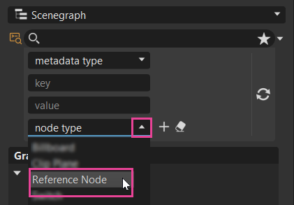

We added Reference Node to the Scenegraph filter list.
Scenegraph advanced filter list displaying Reference Node

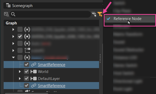

Use it to quickly select all reference nodes in the Scenegraph.
Scenegraph filter list displaying Reference Node

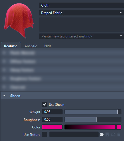

We added a conversion option for the deprecated velvet and woven cloth materials. When loading a scene containing either of these materials, a dialog appears with the option for converting them into a plastic material with a sheen, recreating a similar, but not exact, material. Choosing Yes converts these materials. If No is chosen, nothing is converted; however, in Vulkan, these materials will appear pink when rendered but will be fine in other renderers.

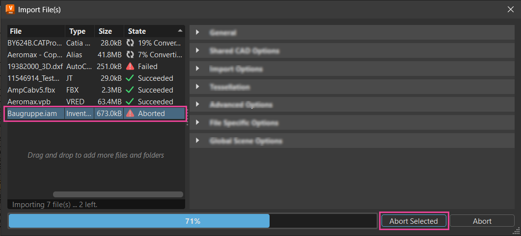

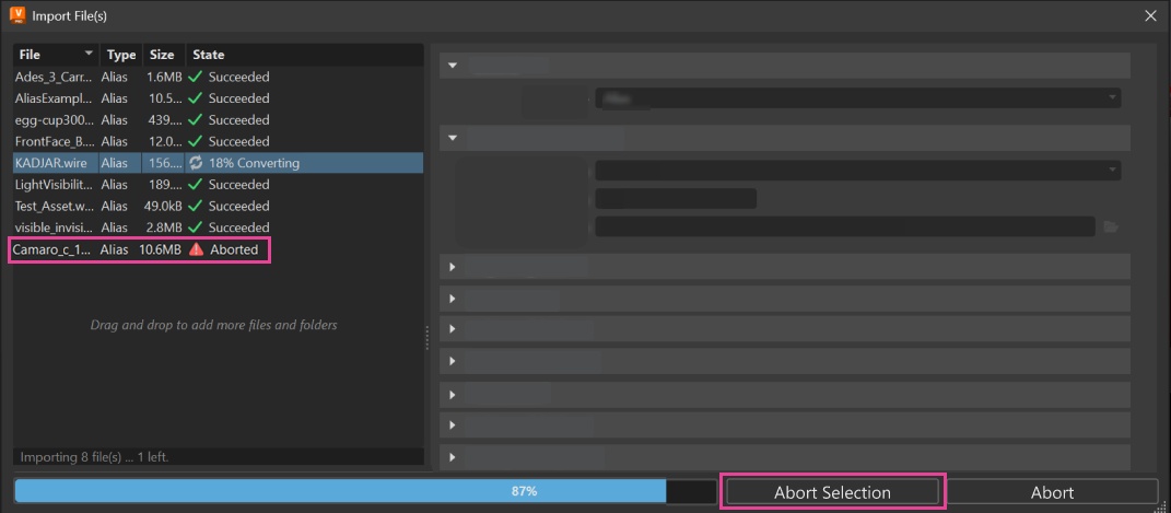

Now, after clicking Import, a new button, Abort Selected, appears in Import File(s) Dialog. Use it to abort the import of a specific file.
List with Red Warning Triangle
In the file list, click a file to highlight and select it, then click Abort Selected. Red Warning Triangle icon Aborted will appear next to the selected file. Use this to save time, by not loading one or more files.
