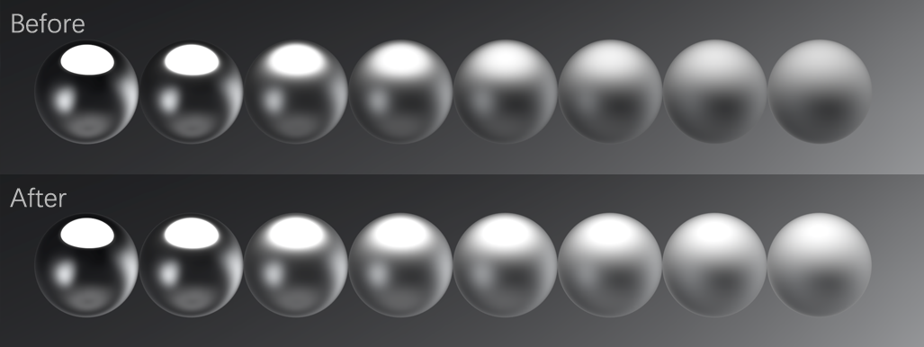

GGX BRDF Shader Model (2022)
VRED now uses a GGX BRDF model for all materials. This is THE standard for many render engines, as it improves light reflections for rough surfaces, making them look more realistic, by using GGX as this new default BRDF behavior. It allows high fidelity simulation of material reflection at both peek and shallow viewing angles, resulting in a subtle softer highlight that falls off gradually. This option has improved importance sampling and is better at energy preservation.
Energy Preserving GGX
Energy Preserving GGX uses a multi-scattering approximation to improve the preservation of a material's energy, especially for high roughness values, creating a realistic material that maintains its properties in any lighting condition. Its improved importance sampling method reduces the chances of fireflies.

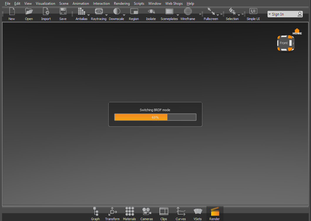

When opening a scene created before 2022, a dialog appears asking whether to migrate the scene into the new GGX BRDF (Bidirectional Reflectance Distribution Function) model or stick with the "old" behavior.
In the Render Settings, it is possible to migrate the scene to the new GGX BRDF model at any time.
