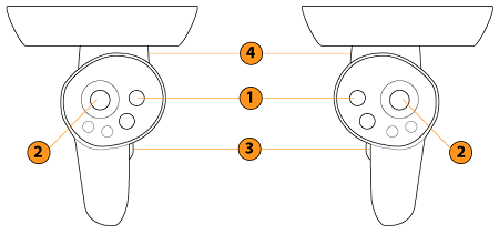

HP Reverb G2
The HP Reverb G2 hardware, uses the OpenVR HMD mode, which uses SteamVR. An internet connection is initially required for the VRED controller bindings (controller button mapping). Once the controller bindings are loaded, the internet is not required.
VR Menu (AB/XY button)
Teleport (Thumb-stick)
Tooltips (Grip)
Pointer (Trigger)
VR Menu
Use the AB/XY button to access the VR Menu.
- To display and close the VR Menu, press the Y top button (left controller) and B (right controller).
Teleporting
Use the thumb-stick for teleporting.
- To activate Teleport, move the thumb-stick in any direction.
- To teleport, press the moved thumb-stick. This also completes the teleport.
- To cancel Teleport, release the thumb-stick.
Tooltips
Use the grip to access tooltips.
- To open the tooltip for the active tool, squeeze the grip.
- To close the tooltip, release the grip.
Laser Pointer
Use the trigger for pointing.
Note:
There is no haptical feedback for press/release.
- To activate the laser pointer, pull the trigger half way.
- To execute and use the laser pointer, completely pull the trigger.
- To cancel or finish using the laser pointer, release the trigger.
