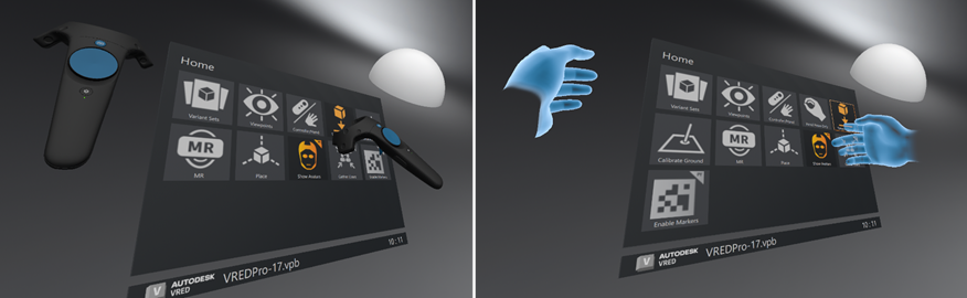

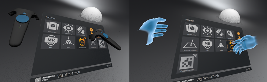

Improved VR Visualizations Raytracing
All VR visualizations (VR devices and hands) are now rendered in raytracing with color corrections, such as tonemapping and gamma, applied.
Note:
The flashlight doesn't currently work, since that is not added in our internal code using a Python script.
2025.2 OpenGL 2025.2 Raytracing
Controllers and hands in 2025.1 Controllers and hands in 2025.2
