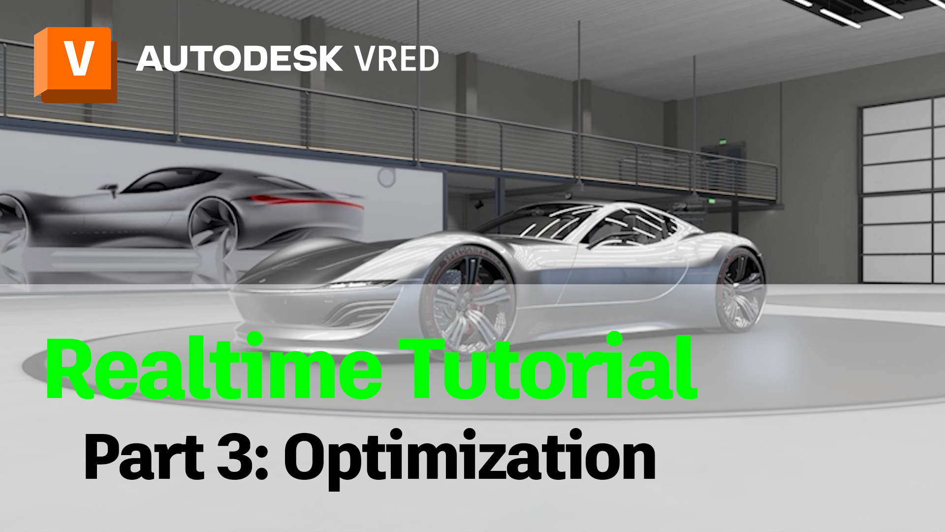

Part 3: Variant Sets and Interactions
In this third, you will learn about variants sets and interactions.
