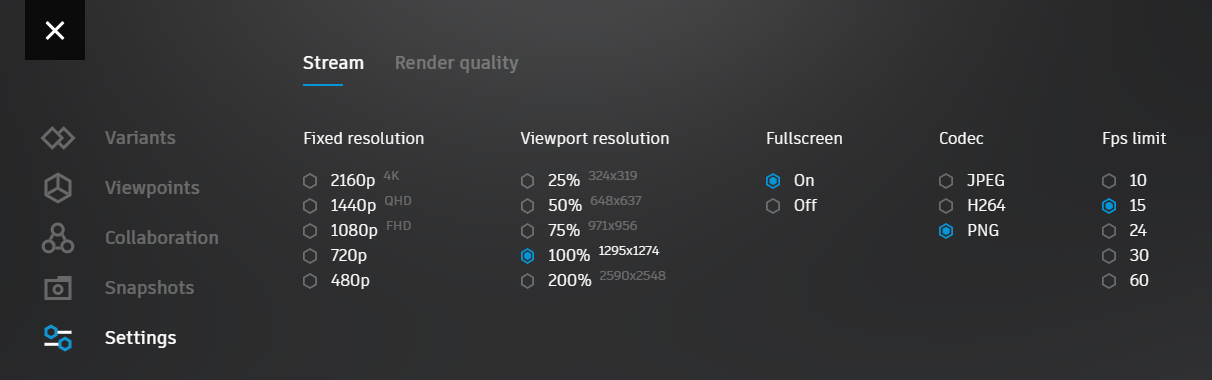

This feature provides a way to stream a PNG image with transparency.
We added the PNG option to the list of codecs for the web interface.
PNG with alpha channel
The PNG codec provides a way to stream a PNG image with a transparent background that can be placed over custom web content. It can also be used when an image with no visible compression artifacts is required. It creates a lossless image format, but requires more bandwidth.
  1. Start the Stream App.
  2. Click the = button, then Settings.
  3. Under Codec, select PNG to stream a PNG with an alpha channel.
