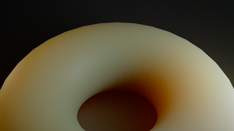

Reduced Faceting
We reduced faceting to hide low tessellation when using subsurface scattering, where light intensity rapidly decreases as it penetrates and scatters within a material.
2026 2026.2
Low tessellation when using subsurface scattering Fixed low tessellation when using subsurface scattering wby reducing faceting
