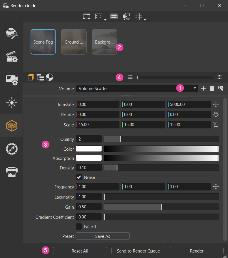

We added film grain camera effects to the Effects category and introduced a new Volume Fog icon Volume Fog category, for quickly adding fog to your scene. Choose from background, ground, and scene fog presets. Volume Fog works a bit differently from the other categories, as a volume scatter node needs to be created or selected before a preset is assigned. If the default settings need some tweaking, use the properties to customize the effect further, then save the changes.

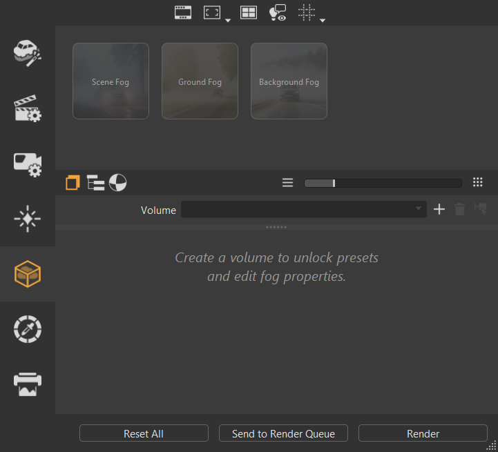

When first accessing the Volume Fog category, you are prompted to create a volume to unlock the presets and edit their properties. This makes the volume fog workflow different from the other categories.
Opening Volume Fog screen
Start by creating a volume 1. From there, select a preset 2. If modifications are needed, use the properties to make changes, and if additional options are needed, use the quick access editor/module buttons 3. To save the modification to the volume and create a customizable volume fog preset, click Save or Save As 3.
Volume Fog category
1 Volume
Use these tools to create or select a volume.
  • Volume - Provides a list of volumes. When the field is blank, click Create icon - a plus sign inside a square to create a volume scatter node. Once a volume is selected, its properties are loaded.
Use the buttons next to Volume for the following:
  • Create icon - a plus sign inside a square Create - Creates a volume scatter node, adding it to the Scenegraph, Material Editor, and Volume dropdown. Now, it can be chosen as the target for a selected preset. Its settings are loaded into the Properties.
  • Delete icon Delete - Deletes the displayed volume from the dropdown menu and removes it from the Scenegraph and Material Editor. This is greyed out when there are no volumes.
  • Select a node icon Select in Scenegraph - Selects the Volume in the Scenegraph, making it easy to find. This is greyed out when there are no volumes.

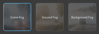

2 Presets
We've added the following presets:
Volume fog presets
  • Scene Fog - Adds fog to your overall scene.
  • Ground Fog - Adds fog to the ground of your scene.
  • Background Fog - Adds fog to the background of your scene.
Like with other presets, click a preset to load its properties. Use the default settings or adjust them. When a preset is altered, it is framed in yellow and yellow warning icon appears within it. Click Save As to save the changes, remove the icon, and create a blue framed preset with two icons below its editable name.
Unaltered Preset Altered Unsaved Preset Altered Saved Preset
New Preset
Custom Fog Preset icon There are a few workflows for creating a new preset. See Creating a Custom Preset for instructions for each. In all cases, the preset can be renamed and a custom thumbnail image assigned.
Below the preset name are the following tools:
Preset Image Preset Image - Enables a custom image (PNG, JPG, JPEG, or BMP image file formats) to be added for the preset thumbnail to distinguish it from others. Locate and select an image, then click Open to load and use it as the preset image.
Delete - Deletes the current preset.
Important:
If changes are made to a templated preset, if the Volume option is changed, the preset changes are lost, unless Save or Save As was clicked. This ensures that these templated presets are not overwritten.
3 Properties

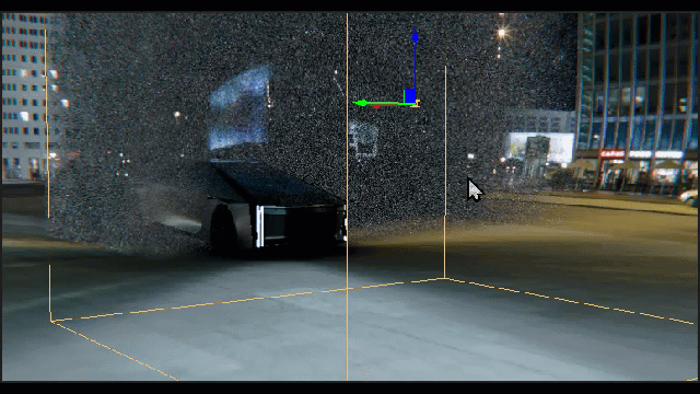

When a preset is selected, its properties are loaded and can be tweaked to create a custom volume fog preset.
  • Translate, Rotate, and Scale - Transforms the volume fog node. Either enter values in the fields provided or click the icons, Translate icon, Rotate icon, and Scale icon, to the side to display a transform manipulator for manually modify these settings.
    Using manips
  • Quality - Controls the number of samples taken along each view ray. For maximum performance, enter 1, but for maximum quality, enter 8.
  • Color - Sets the color of the light scattered by the volume.
  • Absortion - Sets the color of the remaining light after absorption by the volume.
  • Density - Sets how far light travels through the volume before being scatter or absorbed.
  • Noise - Enables the addition of noise to the fog.
  • Frequency - Sets the noise frequency in each dimension.
  • Lacunarity - Sets how quickly the frequency increases with every octave.
  • Gain - Remaps the noise values to either increase or decrease the spread of values.
  • Gradient Coefficient - Scales the amount the next noise octave evaluation is modified by the gradient of the previous.
  • Falloff - Enables falloff of the volume material for a smoother transition along its edges.
  • Offset - Controls the origin of the falloff. A value of -1 starts at the bottom of the given axis. A value of +1 starts at the top of the given axis.
  • Scale - Sets the amount of falloff for each dimension.
  • Gain - Increases the falloff rate.
  • Save - Saves changes to the selected preset.
  • Save As - Creates a custom preset with a blue outline (when active). This custom preset will appear in the Volume dropdown.
4 Splitter Bar Tools
These tools were added to the splitter bar for accessing the following:
Scenegraph icon Scenegraph - Opens the Scenegraph for further customization of settings not available in the Render Guide.
Material Editor icon Material Editor - Opens the Material Editor for further customization of settings not available in the Render Guide.
5 Render Options
Once all changes are made within the guide, use one of these buttons at the bottom of the module to start image calculations.
  • Reset All - Resets all the categories. The reset values are updated when loading a project or when creating a new scene.
  • Send to Render Queue - Opens a file browser to name and set the location of the saved renderings, then opens the Render Queue, where the image names cannot be changed. Use the buttons along the bottom to send all renders to the Cluster Queue, add them to the Render Queue, or render all. See To Start Image Calculations for more details.
  • Render - Opens a file browser to name and setting the location of the saved renderings, then creates the image or movie at that location using the current settings. An image's name can be changed during this process.

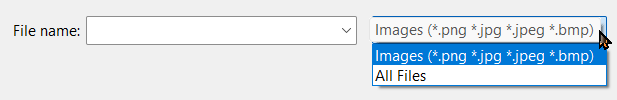

Adding a Custom Preset Thumbnail
For a custom preset thumbnail, VRED supports PNG, JPG, JPEG, and BMP image file formats.
Tip:
If you change the image file format to All Files, then any image format supported by Qt can be loaded. See https://doc.qt.io/qt-6/qtimageformats-index.html for more information.
All Files
  1. Click Preset Image.
  2. Navigate and select an image to represent the preset.
  3. Click Open.

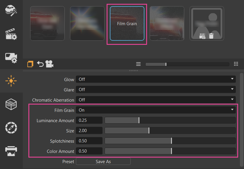

Effects icon Effects
We have added the newly introduced Film Grain camera effect.

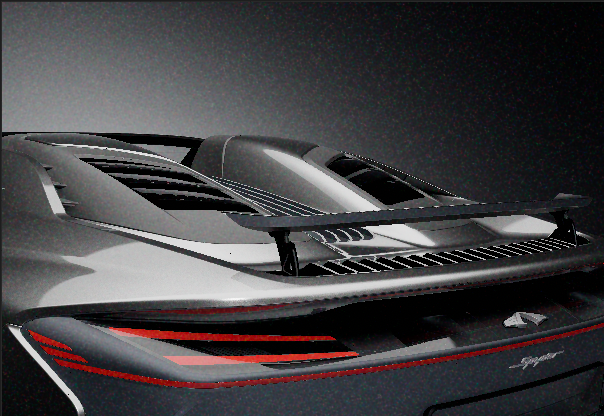

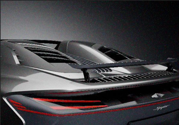

  • Film Grain - Enables or disables film grain, which creates a cinematic camera effect that distorts clean rendering and shifts it for a very emotional look. It simulates the noise of the camera and is more visible in darker areas, than light. It is pixel-based, so its size is always relative to the rendered resolution. The noise pattern changes with each frame.
    Film Grain
  • Luminance Amount - Sets the amount of luminance film grain.
    Luminance Amount = 0.25 Luminance Amount = 1
    Film grain with a Luminance Amount of 0.25 Film grain with a Luminance Amount of 1

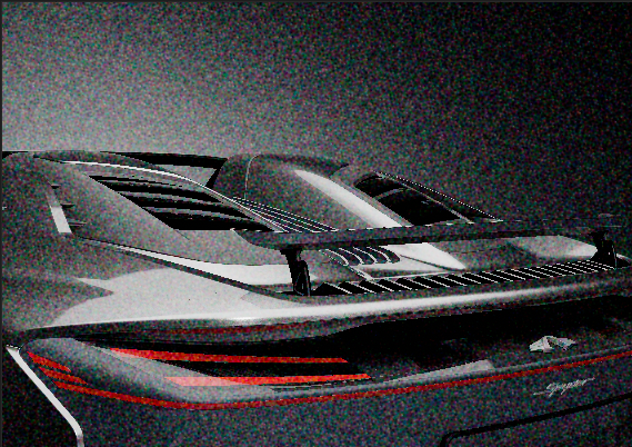

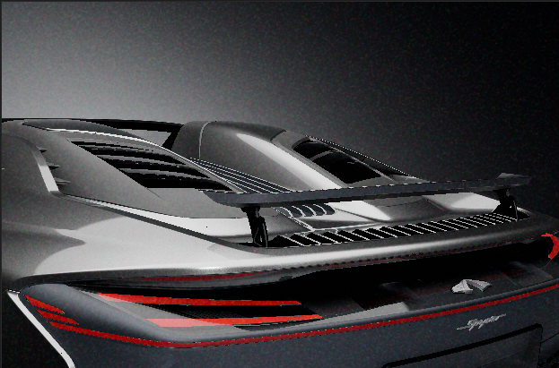

  • Size - Sets the size of the grains.
    Size = 2 Size = 4.87
    Film grain with a size of 2 Film grain with a size of 4.87
  • Splotchiness - Sets the intensity of the splotches in the film grain.
    Splotchiness = 0.5 Splotchiness = 1
    Film grain with a Splotchiness of 0.5 Film grain with a Splotchiness of 1
  • Color Amount - Sets the amount of colored film grain.
    Color Amount = 0.5 Color Amount = 1
    Film grain with a Color Amount of 0.5 Film grain with a Color Amount of 1
