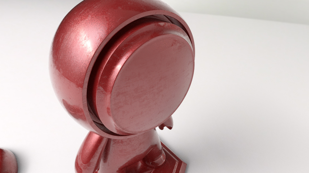

Video captions: For those working with Substance materials, I am happy to show you that you can now work with metallic roughness and coated workflows. Like here, where I'm using the coat layer nodes within Substance Designer. And, I now have the ability to control this coat layer, separately, within VRED. This gives you so much more freedom in creating your materials and improves your visual quality. And, additionally, you have the option to tell if the Substance textures should be inlined or not. This can make the scene file smaller.

With VRED 2025.2, it is now possible to use Adobe Substance SBSAR materials that are using the Metallic Roughness - Coated workflow. This means that the following additional output channels are now supported and can be combined with the already supported channels.
  • Coat Opacity
  • Coat Roughness
  • Coat Color
  • Coat Normal
  • Coat Specular Level
  • Coat IOR (numerical output only, no texture)
With VRED 2025.2, the following Substance workflows are supported:
  • Metallic Roughness
  • Metallic Roughness - Anisotropy
  • Metallic Roughness - Coated
