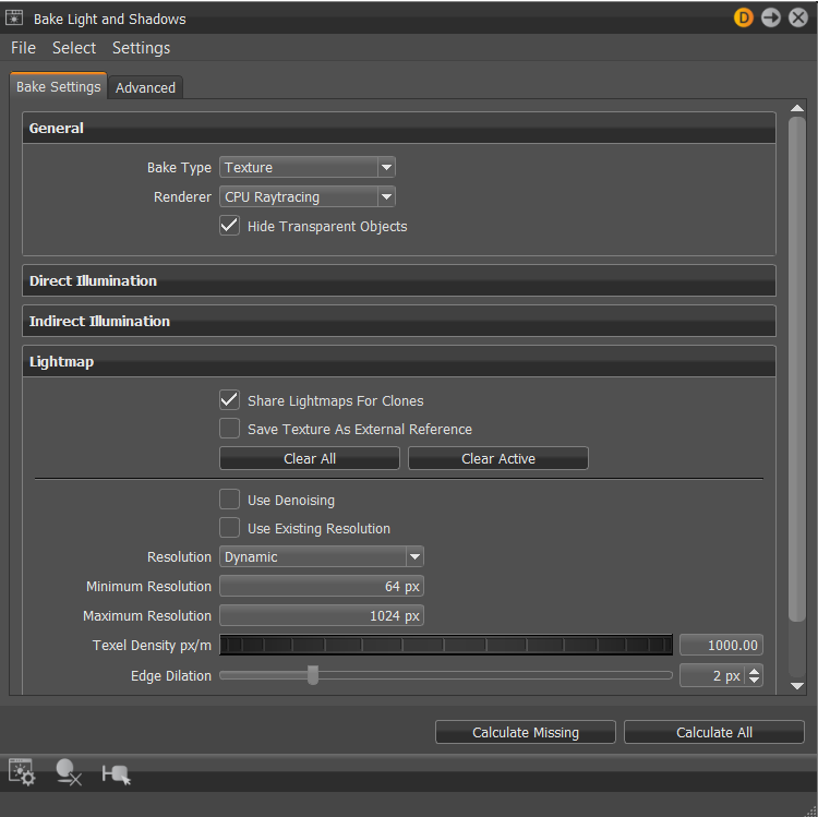

Texture Baking
It is now possible to bake high-quality results on low polygon objects without subdividing meshes. Use the Bake Type option to switch between vertex and texture bake lightmap generation.

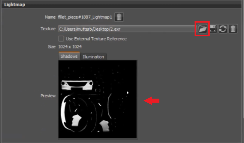

Lightmap Preview
Only available for nodes with the Texture Bake Type where bake calculations were preformed.
See a preview of the shadow and illumination maps of the lightmap for the geometry selected in the viewport. Load, save, reload, or delete a texture image, as well as set whether or not to use an external texture reference. See the Lightmap section for more information.
To better judge the baked result in the scene, toggle between the different Visualization modes in the Visualization menu or double-check the lightmap texture directly in the UV Editor.

Bake Settings Tab
The Bake Settings tab contains parameters for configuring direct and indirect illumination, subdivisions, lightmap behavior, lightmap UV generation, as well as setting the bake type and finally calculating the bake. Here are some of the highlights:
- For baking textures, start with Bake Type
- For setting the raytracing used, see Renderer
- For hiding glass and transparent objects, use Hide Transparent Objects
- If working with ambient occlusion, see Weighting
- For sharing lightmaps for clones in a scene, try Share Lightmaps for Clones
Advanced Tab
The Advanced tab contains parameters for seeing settings used to bake the selected object in the scene in the viewport. See the bake settings applied, as well as a preview of the shadow and illumination maps. Save the texture as an .exr file and use the Active Bake option to turn off baking or switch between texture and vertex.
