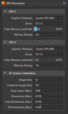

GPU Information Dialog
In the Help menu, we renamed GL Info to GPU Information and adjusted the styling. The content is streamlined and focuses on what's most relevant for you. It now provides GPU stats for each graphics card used, such as the kind of graphics card, driver, minimum and maximum video memory used, and whether memory is shared. For OpenGL, it provides the image units, combined image units, as well as the maximum texture limits for array layers and dimensions. When displayed, you can still interact with VRED. Find it under Help > GPU Information.
GPU Information dialog

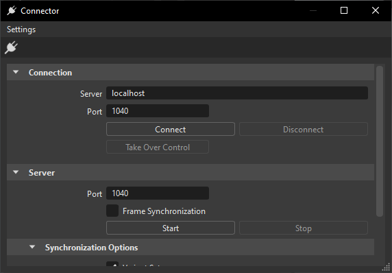

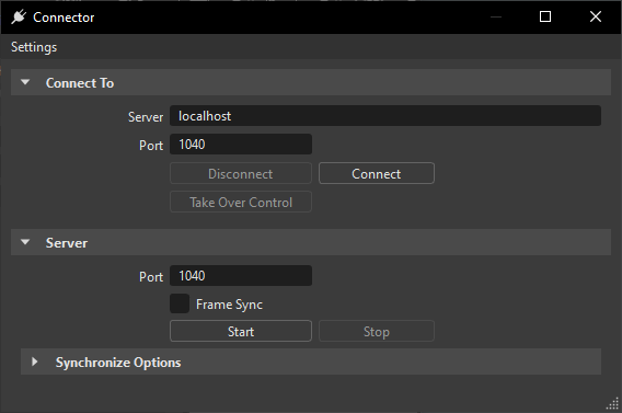

Connector Layout
The layout of the Connector has been modified to follow the current modernization standards.
2025 Layout 2025.2 Layout
2025 Connector Layout 2025.2 Connector Layout
