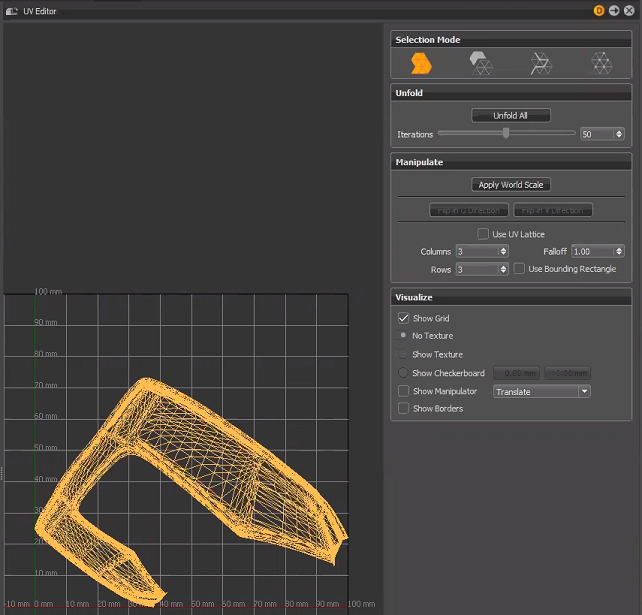

This feature now houses projection functions, and uses Unfold3D features for various options, replacing the old Unfold algorithm with Unfold3D to produce better results.
Projection functions were moved to the UV Editor, with the retirement of the Texture Editor.

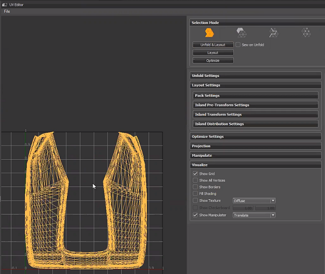

Replaced the old Unfold algorithm with Unfold3D. This produces better results that are closer to Autodesk Maya.
Unfold 2021 Unfold3D 2021.1
Now uses Unfold3D features for Unfold, Layout, Optimize, Constrained Edges.
Added the Layout function to fit selected UV islands to the UV grid, using packing and padding options. In the Selection Mode section, select Select Objects for this option to appear.
Added Optimize UVs with Unfold3D.
Added horizontal/vertical edge constraint with Constrain U and Constrain V to unfold objects like seat belts and tires into a rectangular UV layout.
