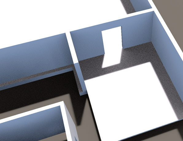

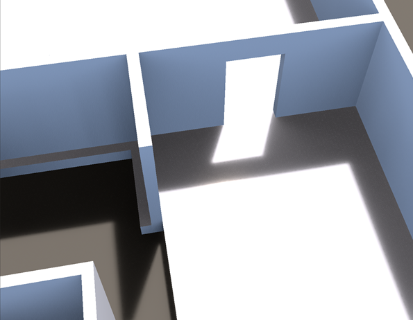

  • Improved the raytraced and raytraced ambient occlusion environment shadow quality when DLSS is disabled.
    Environment Shadows 2026 Environment Shadows 2026.2
    2026 environment shadows showing graininess 2026.2 environment shadows
