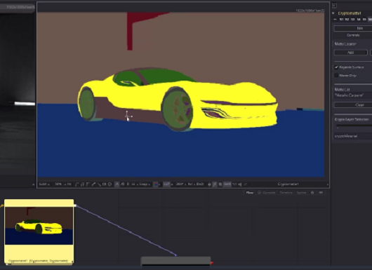

  • Cryptomatte is now supported with GPU Raytracing, which improves and speeds up the image creation and compositing workflows massively.

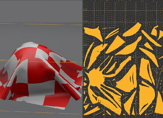

  • We also did some UV Editor improvements. When generating a Triplanar-based projection method, sometimes you get many tiny islands. Therefore, we implemented a new calculation option, called Fewer Islands. It reduces the number of islands for a UV layout, which improves the texturing quality. This option is automatically enabled when in the Bake Light and Shadows dialog when creating a Triplanar-based UV set.

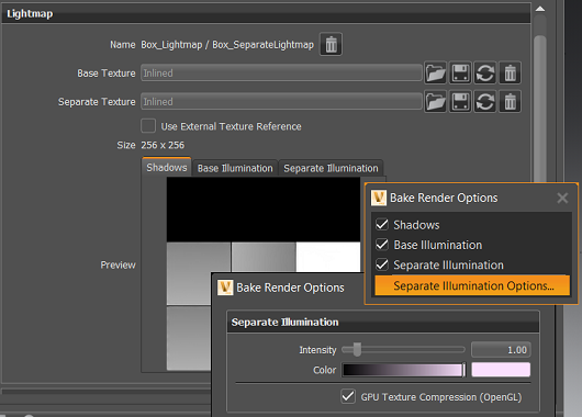

  • For a better quality and more flexibility for realtime scenes, we also added a new option to bake a separate illumination texture channel. You can use this to bake ambient light in car interiors separate from the environment. Now, you can switch the environment independent of the baking like in this scene here. You just have to enable Separate Illumination in the baking tool and also define which light should be calculated separately and which illumination material should be added as well to the separate calculation. Now, I can create a separate illumination channel, which I can observe in the precomputed illumination visualization and I also can control which channel is visible using the new Bake Render Options. But that’s not all, we also added an intensity control for the separate illumination, so you can control the intensity of the baked separate light and also change the color to your needs. You also can control this option using a Python script, and also fading the light is possible, which gives you a very smooth transition when turning on the separate illumination channel. Find also an example which comes with the installation.
