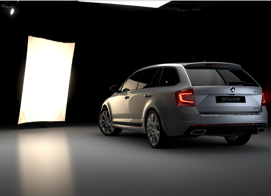

We also added the support for the so-called LTC area lights (Linear Transformed Cosines). These lights work for OpenGL and precomputed modes and give you a much closer look to a Full GI rendered result. The changes affect only area lights in OpenGL and don’t affect the raytracing mode. They calculate the behavior of glossy reflections with less noise. You can clearly see the difference of the old and new behavior. This will massively increase your visual quality for real-time visualization. And also, the Visible in Reflections option is now working the same in OpenGL and Raytracing mode!

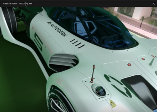

For all users of the Varjo XR3 AR headset, we added a static Marker option. In augmented reality mode, we can add markers to track the virtual model, and now you can change the tracking method from predicted, which is the old behavior, which constantly tracks the object, to a static mode, where the tracking is not done constantly.
You can trigger the new modes using the new Python commands. Now, you just need to add them within the script area of a variant set and you can trigger it from there within the VR menu. If you want to use these scripts, just go to the documentation or find them in the Comment area of the YouTube channel.
