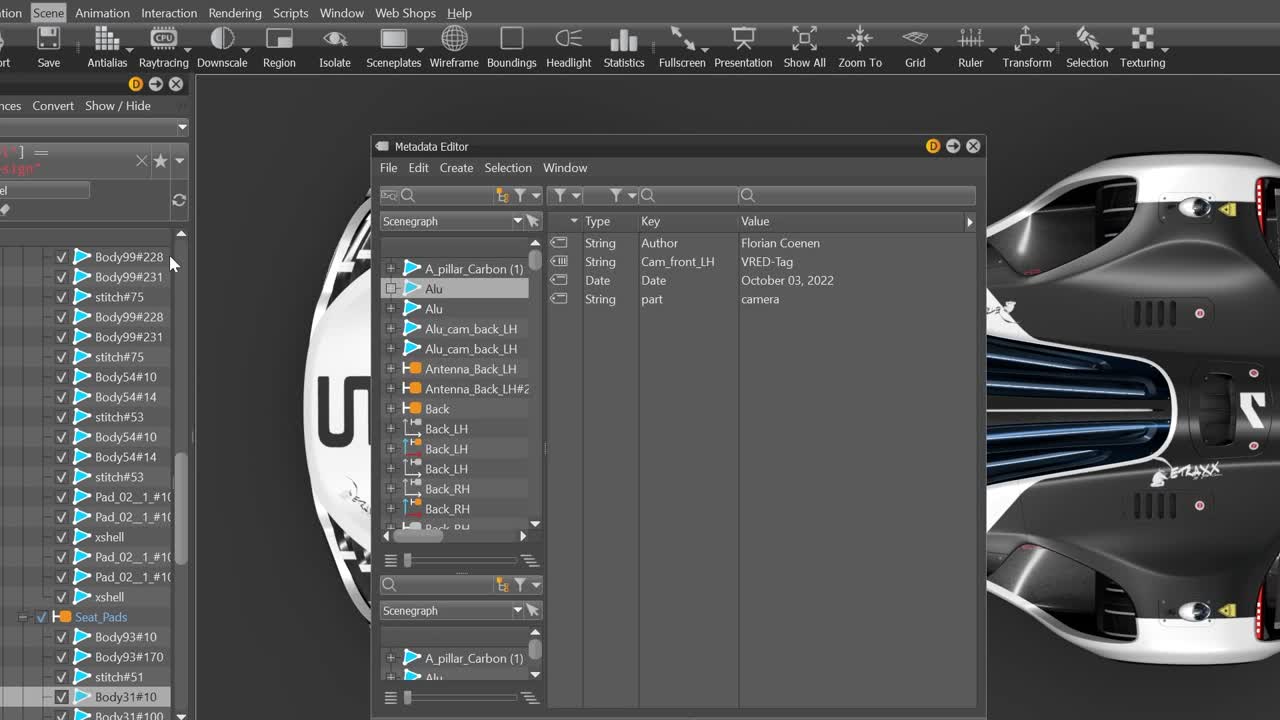

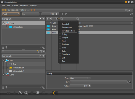

Video Captions: In VRED 2023.3, we added the completely new so-called Metadata Editor. Metadata is information that is attached to a node that can be used to extend workflows or pipeline scripts, while being object name independent. So, with the Metadata Editor, you can create, edit, and control metadata, which is information that is attached to objects, that is normally hidden. I can also use existing metadata that are coming from external CAD applications like Catia or Inventor, and within the Metadata Editor, I can create metadata sets to arrange them to my needs or to search for specific information.

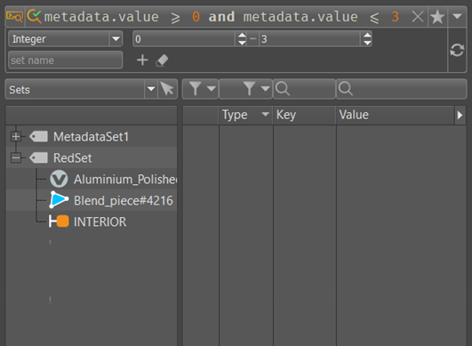

Here is how it works: I can now search and filter nodes without knowing the name of the nodes, by using the metadata information. This can be done using our new advanced search widget, which uses simple Python expressions to search for metadata information. So, I can, for example, search for a specific owner or author. Like here, where I am searching for my name. Now, I see hundreds of nodes. But I can also specify it a bit more and add a date to my search. So now, I only see objects that I have created at this specific date.
And, this advanced search is now implemented in all corresponding editors like the Scenegraph, Material, Camera, Light, and Sceneplate Editor. Or I want to filter for a specific part, like here, the generative design wheels, and in case I need this filter more often, I can also save that query search as a favorite and use the same search within the Material Editor, to find out where the materials of that objects are. So, it’s all about a name independent advanced search and what I do with this, strongly depends on my workflows and also my creativity.
I give you a practical example: Here, I am creating a metadata set for a specific variant or version of the car by simply dragging and dropping the related nodes or materials into the metadata set. In this case, I am adding different wheels and several material switches to my sets. And for a better overview, I can change the color of the sets. Additionally, for future use, I can save the metadata sets or store them in the Asset Manager.

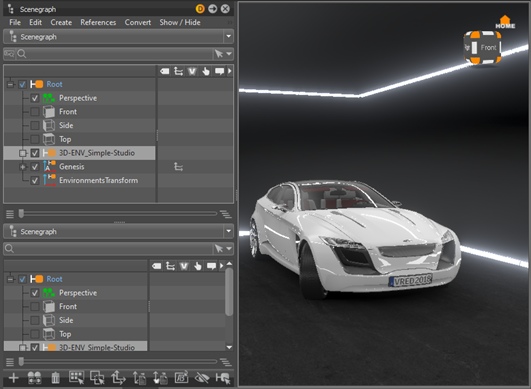

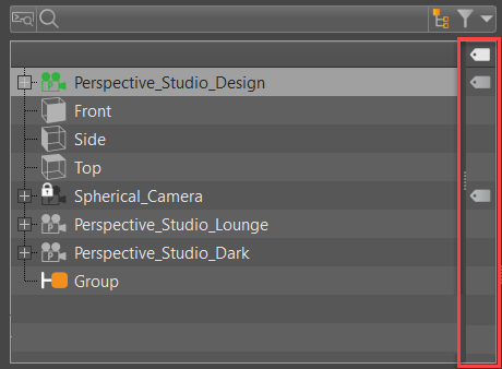

We also decoupled the Scenegraph. This gives you the possibility to access the scenegraph via the Python API. Additionally, we added some more functionality to it. Now, you have access to many more important options directly at this QuickActions Bar and also the context menu is been reorganized. The Scenegraph contains also another section of columns that shows which nodes contain metadata, animation, transform variants, touch sensors, and annotations. This gives you a much better overview of your scene. But the best thing is, you have now direct access to this information. For example, I can double-click onto an icon, like the animation flag, and the corresponding editor will instantly open up. So, you have now direct access to all these values, which can speed up your workflow massively, as I can instantly find the animation curve of an object.
