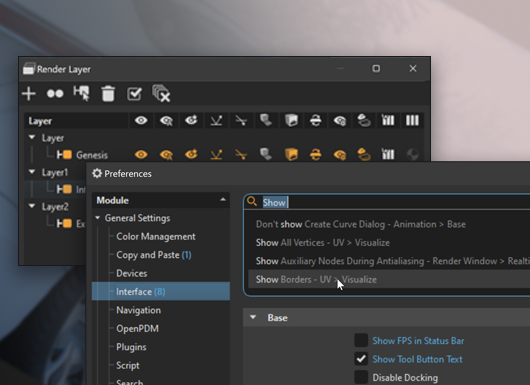

Video Captions: With our efforts on the UI Modernisation, we added several new enhancements. At the start of VRED, you will recognize that we did some changes on the onboarding screen. Here you see a list of recently opened files, which you also can change to a tiled view, to get a better and faster visual overview of your files. You also can open our examples files directly from the Onboarding screen now. And we improved the preference menu. As you see, we have rearranged and categorized the entries. And additionally, when you are searching for specific entries in the preferences, and you don’t know anymore where to find them, we’ve added now a search bar where you can have direct access to the entries you need. This shortens up the time searching for entries massively and makes you faster.
We also improved the UI on some modules like the UV Editor, where you can now scale the windows more dynamically. Also, the Render Layer dialog is now better scalable and changes to icons, instead of text-only when scaled down. This is much better when this window needs to fit into a smaller area for example.

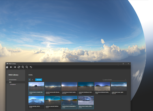

We added a new web shop from Ultraspheres, so you can access the Ultraspheres HDRI images and backplates directly from the user interface. That means that downloaded content will appear in your scene when the download is finished.
Additionally, we added new free environment assets from Ultraspheres, which you can access directly from our VRED library. Just download them from there, unpack them, add the path in the preferences in order to see them directly within the Asset Manager, and use them instantly in your scene.

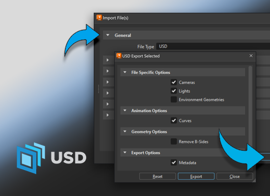

And last, but not least, I’m happy to announce that we implemented the ability to import and export USD files. This gives you a ton of more options and possibilities within your pipeline and also when working with different platforms and teams. So, you can exchange data with different applications, like Maya and many more. For more information about the USD format options, please visit our documentation.
