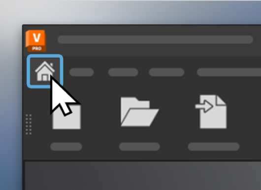

It starts again with the Onboarding screen, which is now the Home screen, and can be accessed directly from the main menu, like many other Autodesk applications, as well. Since the Home screen has evolved over the last few releases, it's no longer just used for onboarding newcomers.

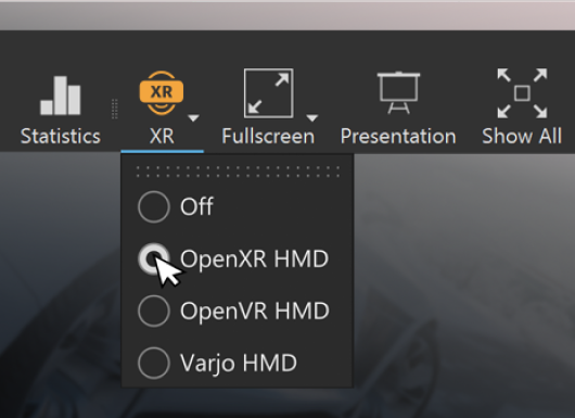

Additionally, now we added the access to go into XR directly on the toolbar. This makes your life much easier now, when you want to switch on and off XR, and speeds up your design review workflow.

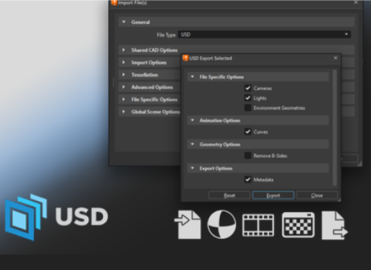

For improving your data pipeline, we added and fixed several things for the brand-new USD file format options. For example, you can now import multiple UV sets for an object, like here, where I am creating a separate UV set in Maya and use this in VRED as a UV set for light baking. And you also can now export an imported vertex cache animation, as well. See more details of the USD improvements in the documentation.

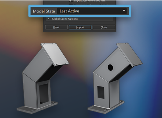

Furthermore, we improved the import of Inventor files. Now, you can decide if the "Primary" or "Last Active" Inventor model state gets imported. This makes working with Inventor files so much more flexible.

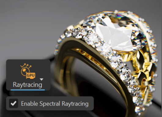

For improving your visual quality, we added some missing features for GPU raytracing. For example, you can now enable spectral raytracing in GPU mode. This is very helpful, if you have computationally intensive tasks, which require spectral raytracing, like translucent materials or light simulations. For example, the new support of translucent AxF materials often contains spectral information, which needs spectral raytracing to be visualized correctly.

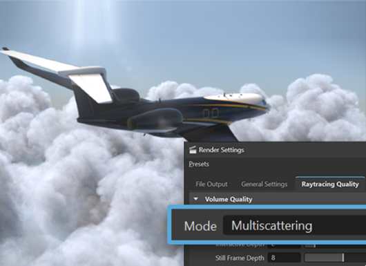

If you are working with volumes, you will be happy to hear that now we added a new calculation method called multi-scattering. This provides a more physically accurate result, as it considers the scattering of light and color within the volume.

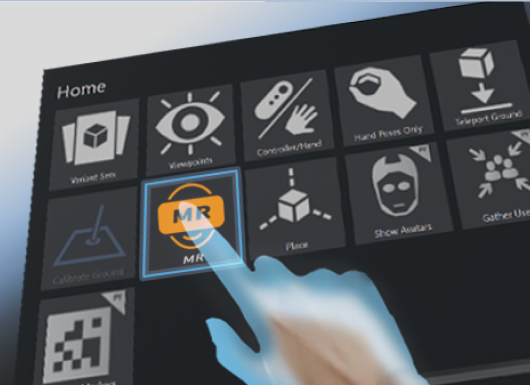

And if you go into VR for design reviews, you have now the full support of the new Varjo XR-4 headset, which works now with hand tracking in Mixed Reality mode, as well. For more information, please have a look at our design studio blog post.

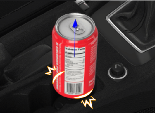

We also added collision detection. This gives you the possibility to visually detect assembly options and much more. With NVIDIA’s latest and updated PhysX engine, we have now much better performance, and we give you access to the API via Python. You can also find two examples in the example folder, which comes with the installation.

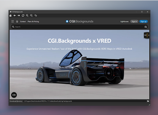

Last, but not least, I am happy to announce, that we added a new web shop for CGI.Backgrounds content directly from our user interface. Like on other web shops, you can just download CGI.Backgrounds content, like backplates and high-resolution environments. Once the download is finished, they will appear automatically in your VRED scene. And CGI.Backgrounds provides 10 free environment assets. These can be downloaded right in our VRED Library. Just download them from there, unpack them, add the path in the preferences, in order to see them directly within the Asset Manager, and use them instantly in your scene.
