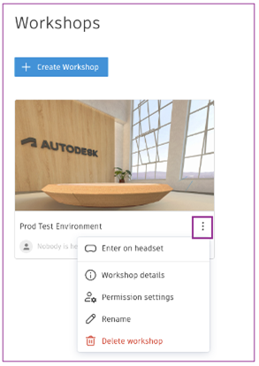

  1. In the Workshop XR web app, select any workshop to open its details panel.
    A screenshot showing the Workshop 3 dot menu
  2. Click the vertical 3 dots next to the name of the Workshop you are adding members to.
    Workshop Menu Permission Settings Highlighted
  3. Select Permissions Settings.

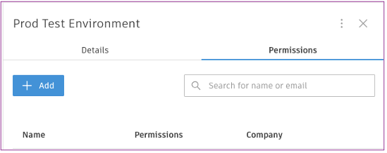

    Permissions setting Tab
  4. A details panel will open up where you can see who is already added and what their permissions are. Click the + Add button.

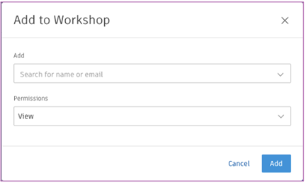

    Add user to Workshop
  5. In the pop-up, you can search for anyone within your project to add to this specific Workshop or add an email. This is also where you can select the member’s permission level.
  6. Click Add.

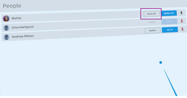

Mute Other Participants
When in a workshop, it can get noisy with everyone talking and excited about the space. Admins can mute all participants to help the design review flow properly.
  1. Open the People Console.
    Core Menu, People Menu Icon
  2. Next to the Admin’s name, click mute all.
    Mute Button in app screenshot
Participants will be able to unmute themselves at any time.

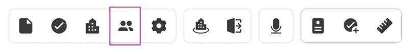

  1. Open Core Menu: Near the bottom of the field of view.
  2. Select the People Button: Represented by icons of two people.
  3. Find the user in the People menu.
  4. Click the Go To button.
