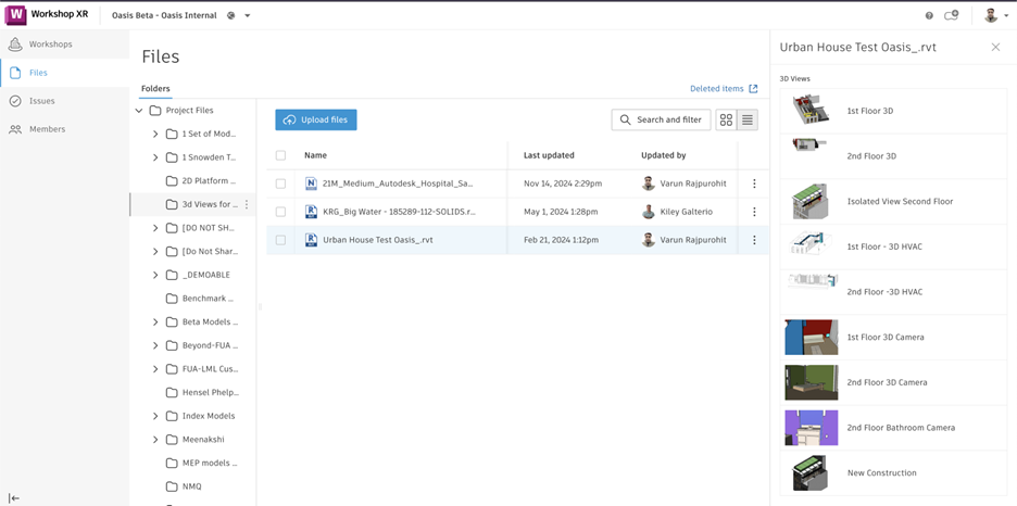

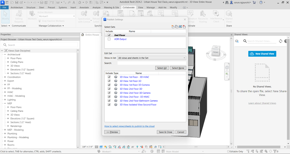

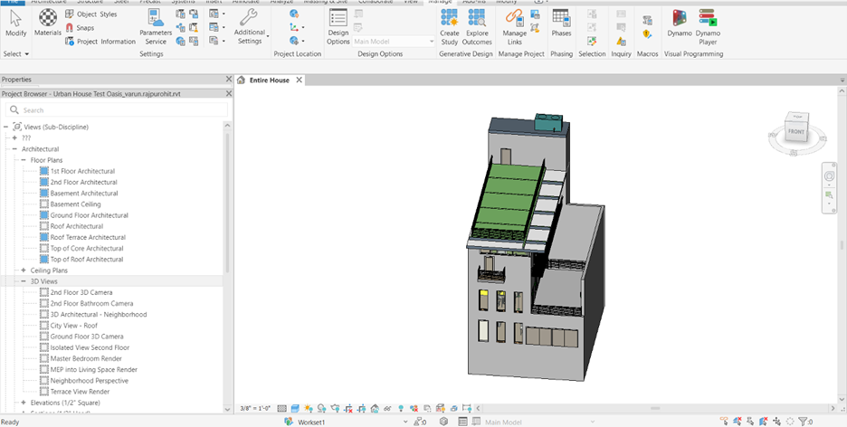

- Create a 3D View in Revit: Start by setting up your 3D view within your Revit model.

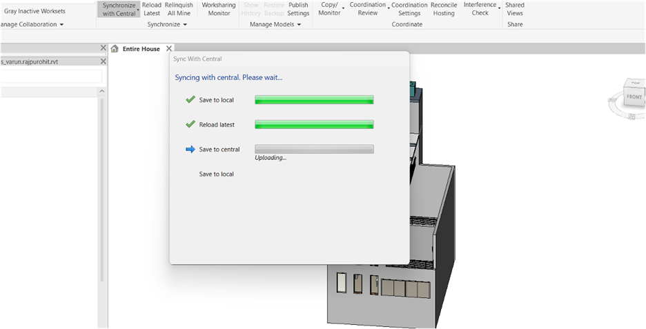

- Sync/Publish to ACC Project: Once the 3D view is created, sync or publish it to your Autodesk Construction Cloud (ACC) project.

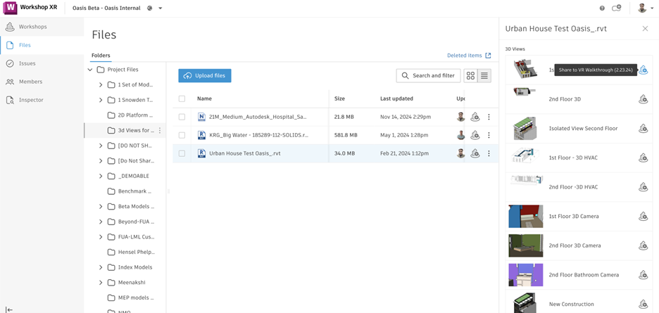

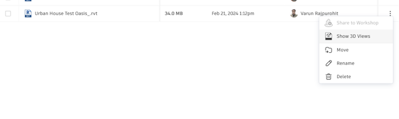

- Access in Workshop XR: After publishing, you can access the 3D views within Workshop XR from within a model.
- Share Easily: Share the 3D view just like you would share any model.
