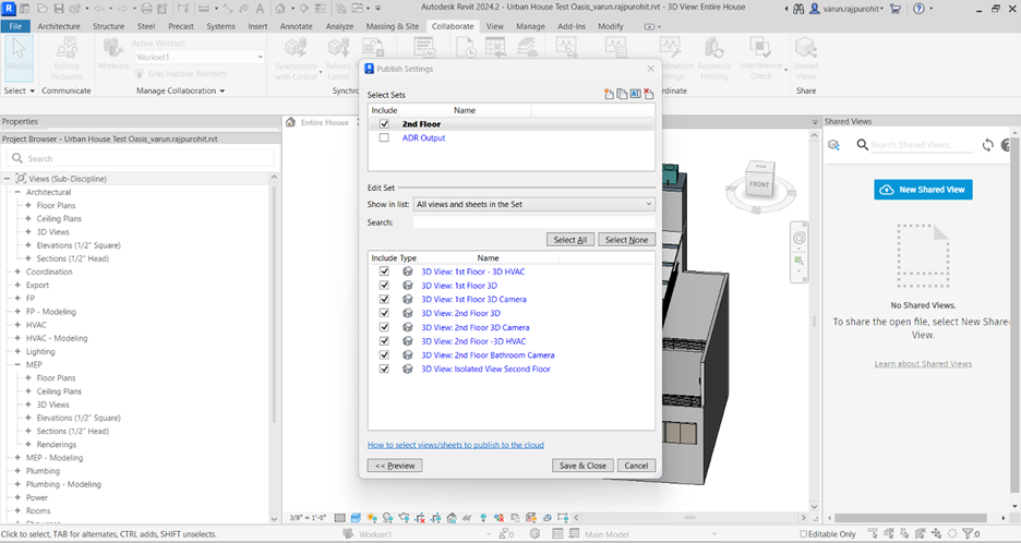

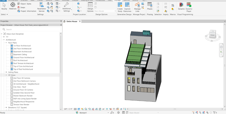

  1. Create a 3D View in Revit: Start by setting up your 3D view within your Revit model.
Create 3D View

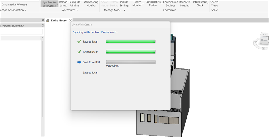

  1. Sync/Publish to ACC Project: Once the 3D view is created, sync or publish it to your Autodesk Construction Cloud (ACC) project.
Sync to ACC Sync to ACC Status Bar

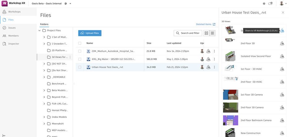

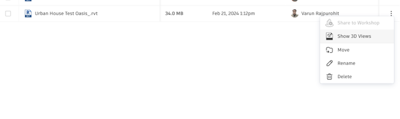

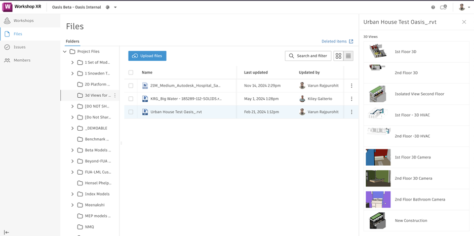

  1. Access in Workshop XR: After publishing, you can access the 3D views within Workshop XR from within a model.
Access in Workshop XR Access in Workshop XR Files Menu
  1. Share Easily: Share the 3D view just like you would share any model.
Share View
