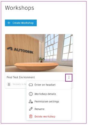

  1. In the Workshop XR web app, select any workshop to open its details panel. First, click the vertical 3 dots next to the name of the Workshop you are adding members to.
A screenshot showing the Workshop Menu
  1. Select Permissions Settings.
A screenshot showing the Permissions Setting option in the Workshop Menu

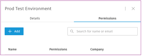

  1. Here a details panel will open up. You will be able to see who is already added and what their permissions are. Simply click the “+ Add” button.
