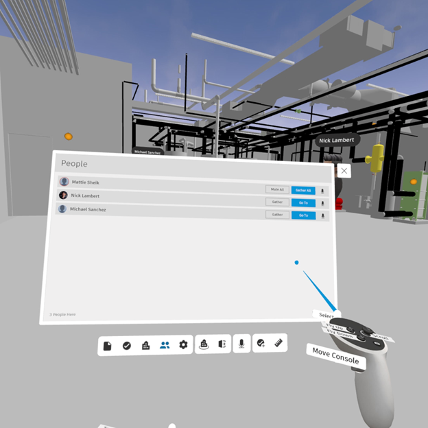

  1. Locate the Core Menu:
    Begin by finding the Core Menu. This is conveniently located near the bottom of your field of view.
    Core Menu
  2. Select People Tab:
    Next, look for the 'People' tab, which is situated near the middle of the Core Menu.
    Gather Option Core Menu

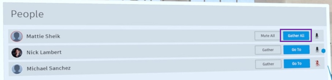

  3. Open the People Menu:
    Upon clicking the People tab, the Console will open the People menu. Here, you'll see a list of all the users currently participating in the workshop.
    People Menu
  4. Gather All Users:
    Finally, click on the 'Gather All' button. This will magically transport all users in the workshop to your current location! An example of the People Console with other users to gather. The gather all button is highlighted
