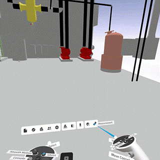

  1. Teleport into Your Model: If you need help with teleportation, check out our teleportation guide.
  2. Click the Measure Tool in the Core Menu.
    Measure Button Core Menu
  3. Simply point and click the trigger on your controller to mark the start point. Then, drag the controller to measure the desired length, and mark the endpoint with another click of the trigger.
    Measure GIF Example

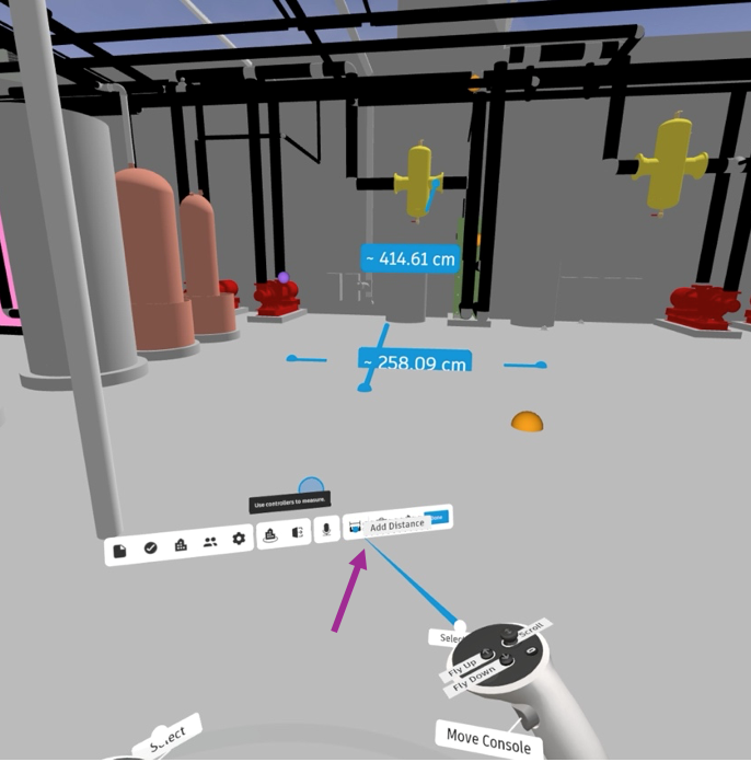

Delete Measurements
  1. Stop Measuring: Click the highlighted "add distance” icon to stop measuring.
    Measure Button Add Distance

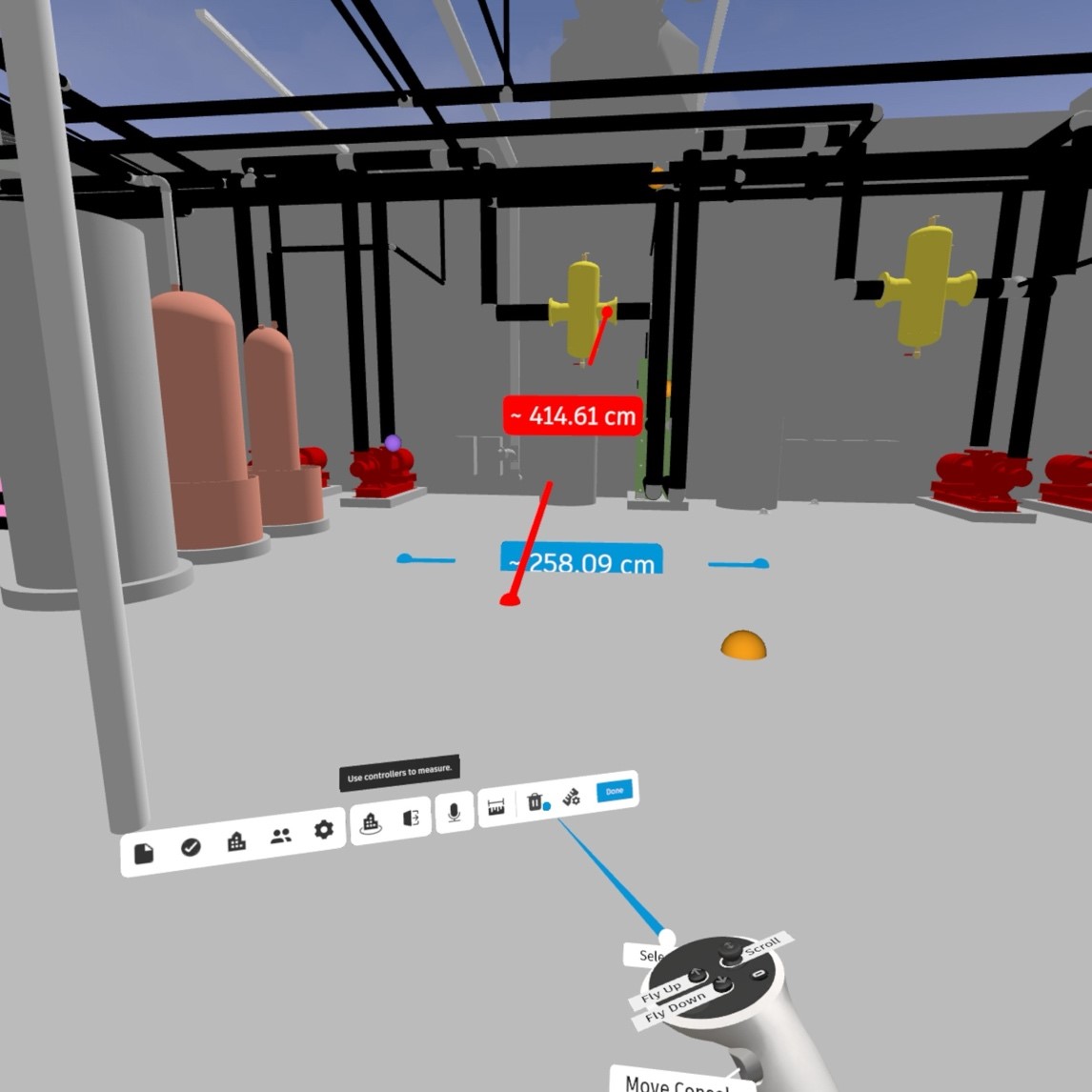

  2. Select the Measurement to Delete: Click on the measurement you wish to delete; it will turn red.
    Delete Measurement
  3. Delete: Click the trash can icon to delete the measurement.

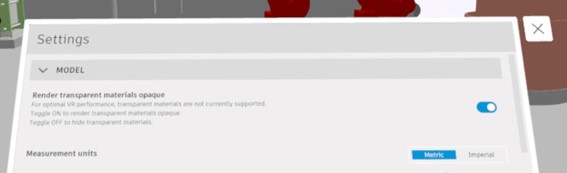

Measure Settings
  • Measurement Units:
    You can choose your measurement units based on your preference. Select either Metric (default) or Imperial in the Settings.
