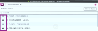

In Autodesk Workshop XR, it can be useful to hide certain elements of the model to allow for deeper examination of otherwise hidden aspects.
Instructions
To access visibility options within Workshop XR, please do the following:
  1. On the Core Menu, select Model.
  2. A new window will open, showing a list of elements with an Eye symbol on the left of each.
Visiblity
  1. Click on the Eye symbol to disable or enable visibility of that element.
  • The bottom of the list contains the main categories of elements, allowing you to toggle groups of elements at a time.
