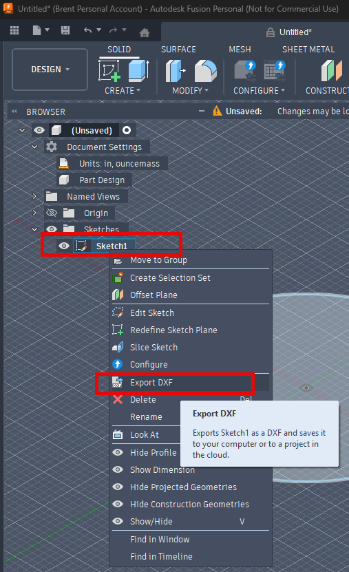

Autodesk Fusion for Personal Use file types
Note: Fusion for Personal use cannot export 3D models as a DXF file, but individual sketches can be exported as DXF files with the right click context menu.
Autodesk Fusion for Personal Use export a sketch as a DXF file type.
