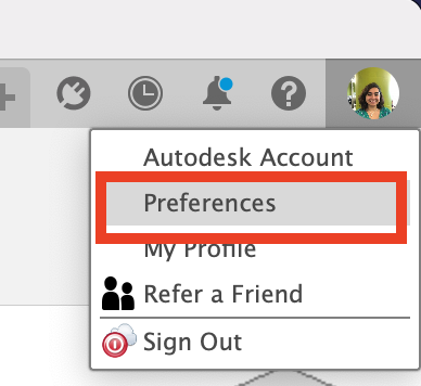

Perform the following:
  1. Click on your profile from the upper right corner of Fusion.
  2. Click Preferences.
Profile menu
