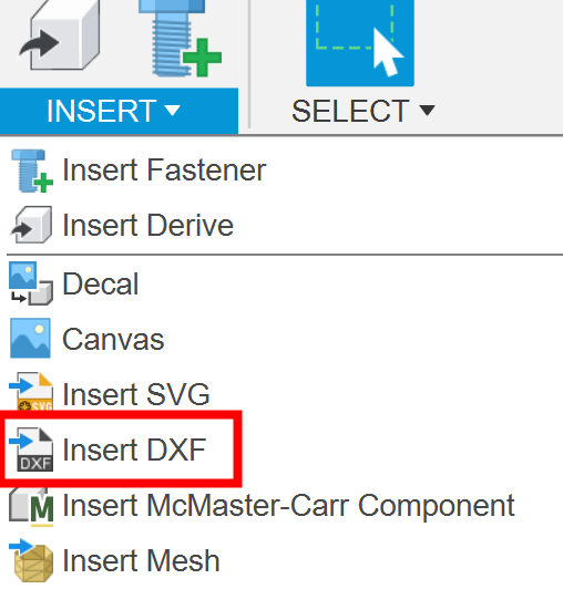

  • Choose Insert DXF from the Insert menu to insert the DXF into an open file.
Insert DXF file

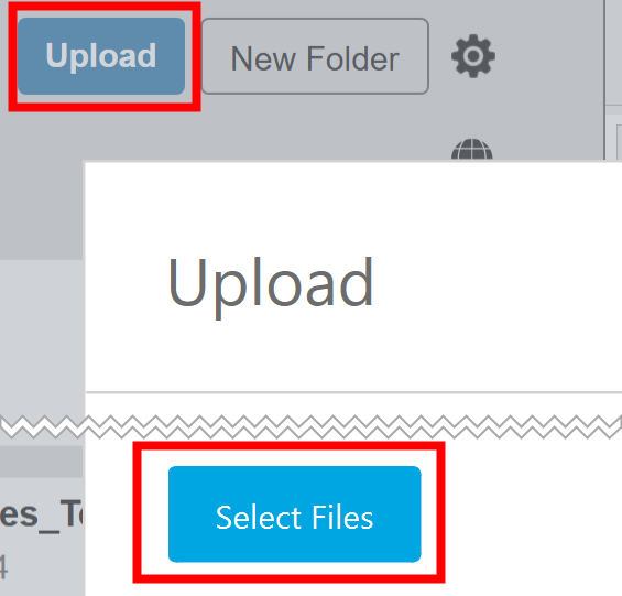

  • Upload the DXF through the Data Panel.
Upload file

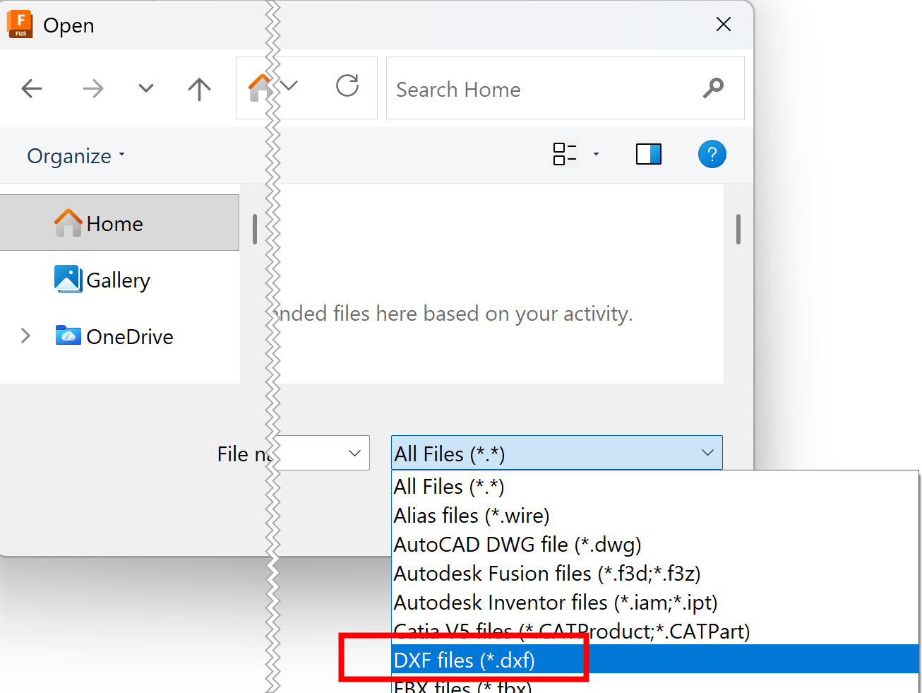

  • File > Open > Open from my computer.
 File open dxf
