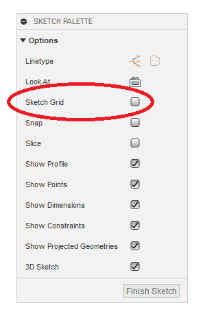

Issue:
The layout grid is turned off but the grid appears when a sketch is open in Fusion 360.
 layout grid
Solution:
Sketch has a separate option for the grid, so when the sketch is open, toggle "sketch grid" to control this.
sketch grid
