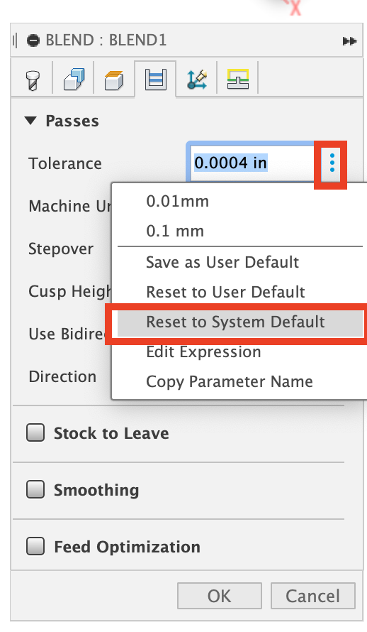

Solution:
Set the tolerance in the toolpath to the Fusion 360 default.
