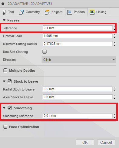

Tolerance Settings:
  • The settings for toolpath tolerance and smoothing (accessed in the "Passes" tab for most operations) can also have a great effect on toolpath calculation times.
  • These settings control how the toolpath is generated in relation to model geometry.

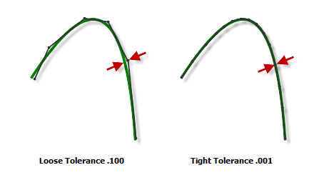

  • CAM toolpaths approximate model geometry by using small linear segments to work around curves.
  • The toolpath tolerance defines the maximum allowable chord distance between the linear segments of the generated toolpath and the actual model geometry.
  • This is visually clear in the Fusion Tolerance tool tip:
Autodesk Fusion : Illustration of Tolerance values

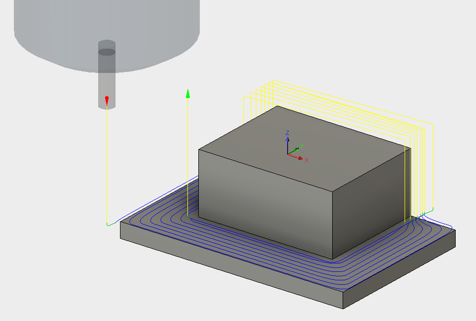

  • Since a toolpath with tight (numerically smaller) tolerance to curved surfaces must create many linear segments, tighter tolerances require longer toolpath calculation times and create larger program files (as more lines of code are required), but will result in more accurate (true to model geometry) cutting path.
  • This can be seen in the following image:
Autodesk Fusion :Effect of Tolerance on a toolpath
  • In the screenshot image, the tolerance is set to 0.01 mm, the default setting in Fusion. The toolpath accurately linearizes the model geometry.
  • The black dots are showing the toolpath points at which the linear segments begin and end, and the size of the g-code program for this operation is 40.4 KB.

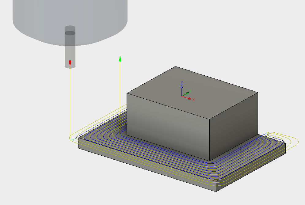

  • Compare this to the following screenshot, in which the tolerance is set to 1 mm as an exaggerated example:
Autodesk Fusion : Effect of a low Tolerance on toolpath points
  • This toolpath generated much more quickly than the one with a tighter tolerance and the size of the G-code program is reduced to 7.5 KB, as the toolpath is allowed to create longer linear segments for the cutting motion.
  • However, this results in reduced accuracy because the chord length from the toolpath to the model geometry can vary by a greater distance.

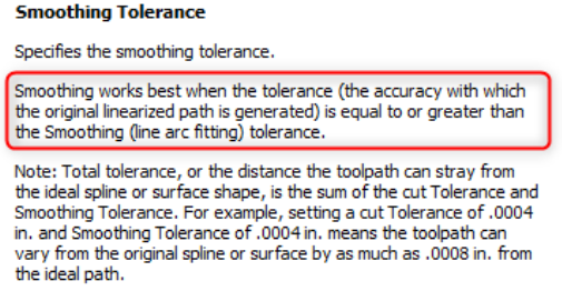

  • Smoothing works to fit G2 and G3 arc moves into the toolpath in place of linear moves when possible, which can shorten the size of the post processed code.
  • The smoothing tolerance defines the amount that arc moves may vary from the toolpath, meaning that the total allowed variance from the model position is the numerical sum of the tolerance and the smoothing tolerance.
  • As an example of how smoothing works, refer to the following screenshot, which has applied a 0.01mm smoothing tolerance to the same toolpath shown previously with the 0.01mm cut tolerance:
Autodesk Fusion : Smoothing tolerance illustrated
  • The number of points has been greatly reduced, which correlated to the change in toolpath size. By enabling smoothing, the g-code program size is now 12 KB, compared to the previous toolpath in which the size was 40.4 KB.
  • It is recommended to use a 1:1 tolerance to smoothing ratio to optimize both toolpath generation times and file sizes when working in Fusion.
