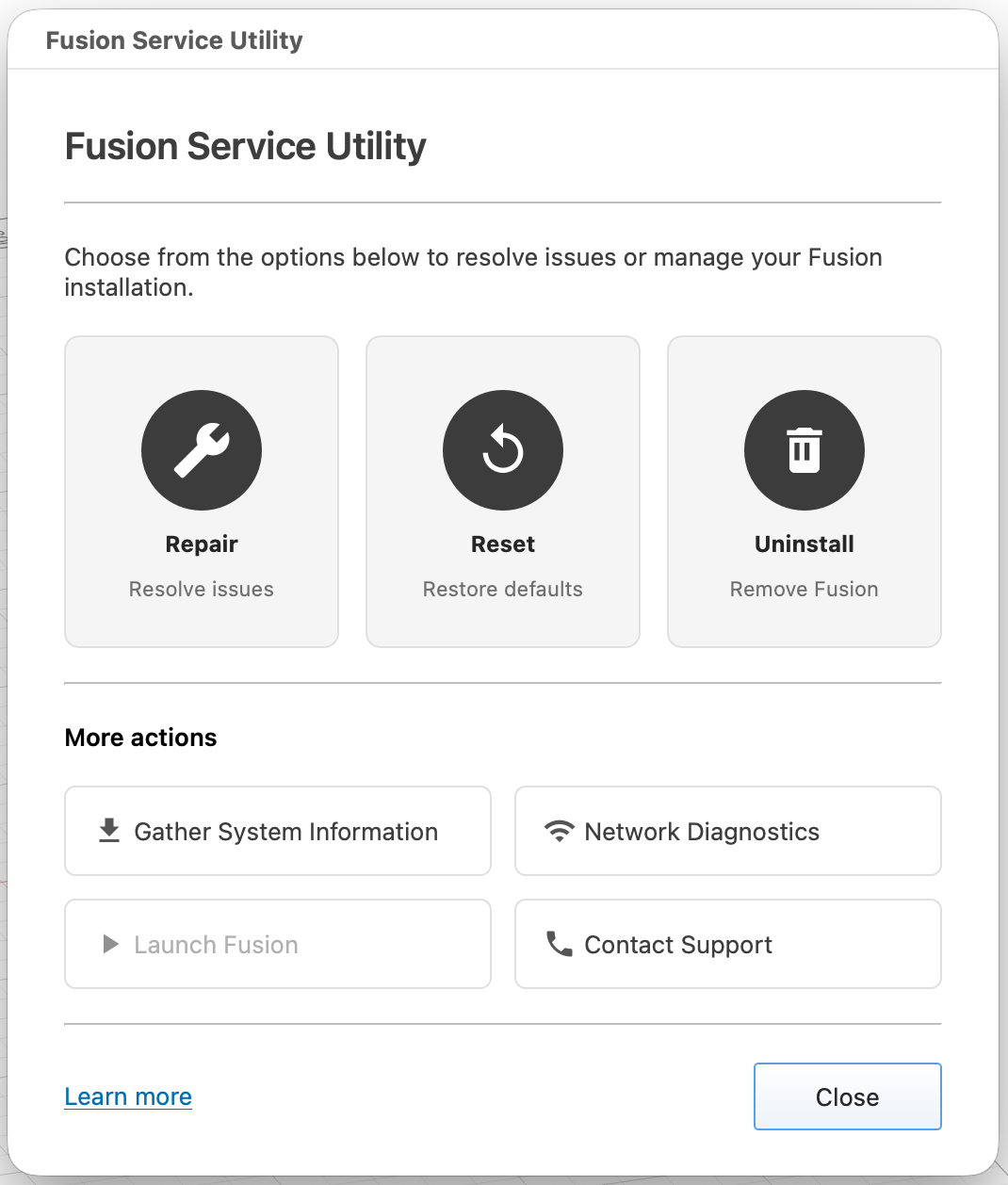

Autodesk Fusion Service Utility is a minimal loading of Fusion that is likely to start when the full application fails to start.
Service Utility offers several tools that can help to resolve start failure issues with Autodesk Fusion.
Fusion Service Utility menu
The Fusion Service Utility is invoked:
Fusion Service Utility offers eight commands. Read about each option in the table below:
Safe Mode Command Name
Description and Use
Related Content
Reset Fusion
Reset command deletes sign in credentials and locally cached files (application related and user design data) that can be replenished from the cloud, upon restarting Fusion.
When should I use this option? This will help with resolving general issues related to Fusion failing to start.
Overview of Reset Fusion Command from Fusion Service Utility.
Launch Fusion
Launch command will attempt to start Fusion again.
Repair Fusion
Repair command performs a lightweight deletion of locally cached files and then reruns install.
When should I use this option? This will help with resolving issues related to corrupt installations (for example, missing DLL warnings) or difficulties with updating Fusion.
Overview of Repair Fusion Command from Fusion Service Utility
Gather System Info
A command for application, installation, and web service log files as well as a system information from your computer.
When should I use this option? When submitting a request for help this will help reduce iterations and improve efficiencies.
Overview of Gather System Information command from Fusion Service Utility
How to manually collect the log files for Autodesk Fusion.
Network Diagnostics
Network Diagnostics performs a network check for key domains used by Fusion application.
When should I use this option? If Fusion is failing to start because of network connection issues, this will give more details about network connection availability.
Overview of Network Diagnostics Command from Fusion Service Utility
Uninstall
Uninstall command performs a lightweight uninstall of Fusion.
For a clean uninstall, follow the steps to manually uninstall Autodesk Fusion.
How to uninstall Fusion using the Fusion Service Utility
How to do a manual clean uninstall of Autodesk Fusion
Close Fusion Service Utility
Close command will exit the Fusion Service Utility
