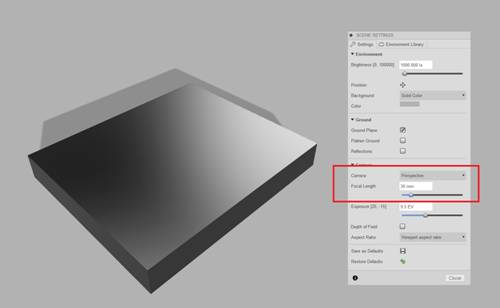

In Fusion, you can change the Focal length is in the render workspace, not the model workspace.
