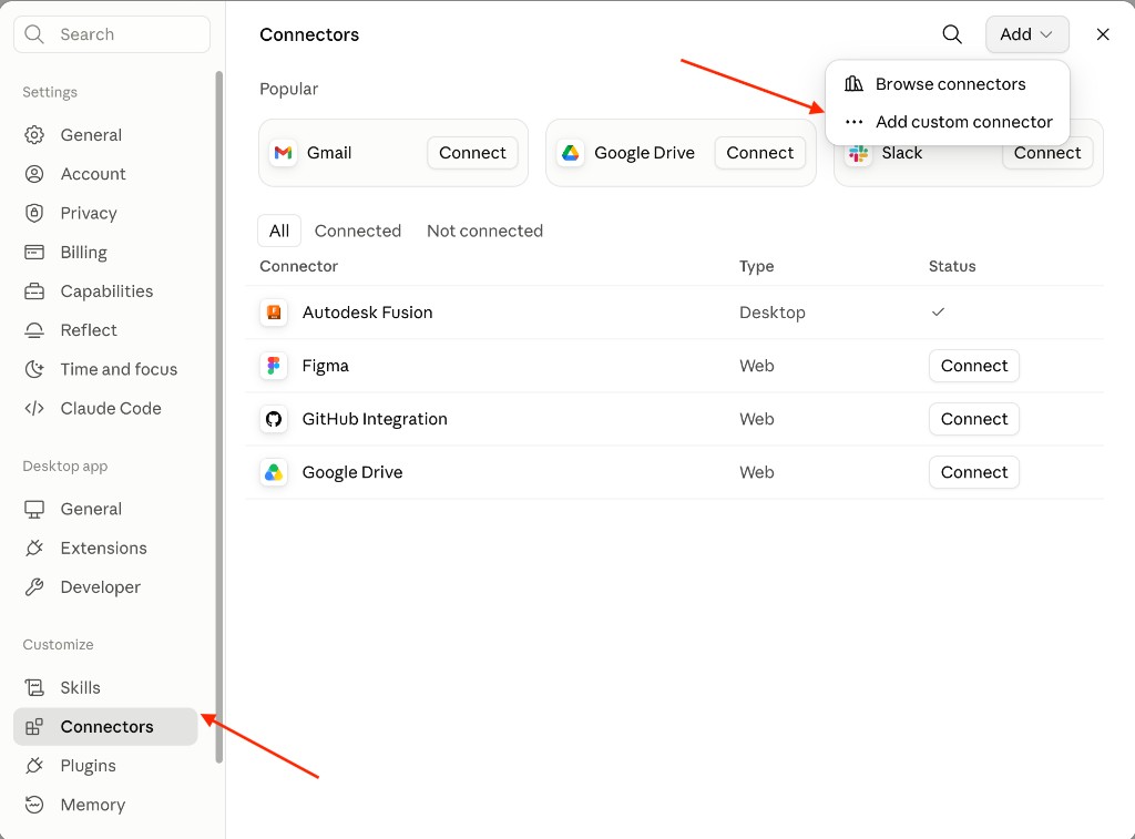

1) Open Claude Desktop connectors
  1. Open Claude Desktop.
  2. Go to Settings > Connectors.
2) Add a custom connector
  1. Select Add at the top right of the Connectors page, then choose Add custom connector.
    Claude Desktop Settings showing the Connectors page, with the Connectors sidebar entry and the Add custom connector option highlighted

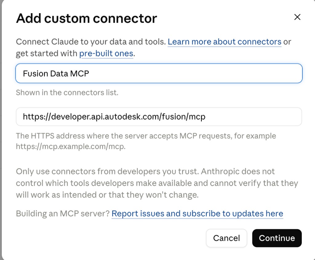

  2. Enter a name for the connector. You choose this name yourself, and it is what appears in your connectors list. This documentation uses Fusion Data MCP.
  3. Enter the server URL:
    https://developer.api.autodesk.com/fusion/mcp
  4. Select Continue, then follow the prompts to sign in with your Autodesk account.
    Claude Desktop Add custom connector dialog with the name set to Fusion Data MCP and the server URL entered

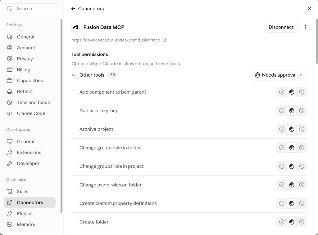

You can also verify in Settings > Connectors. Open the Fusion Data MCP connector and check Tool permissions. If the tool list is populated, Claude is successfully connected. If it is empty, the connection has not been established.
Claude Desktop Fusion Data MCP connector showing the endpoint URL and a populated Tool permissions list
