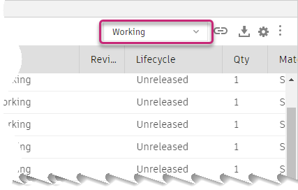

Switch between BOMs
Use the switcher at the top right of the Bill of Materials to show different BOMs for the design:
switcher.
