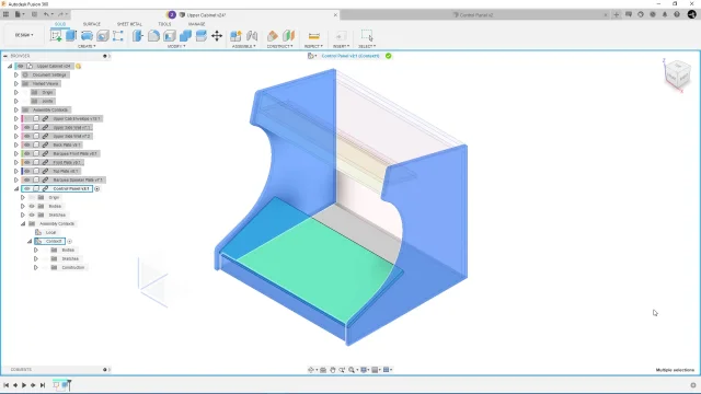

  5. In the Browser or the canvas, select the design features you want to reference in the assembly:
    • Components
    • Bodies
    • Sketches
    • Construction geometry
      reference objects selection example

    In the Browser, the design features you selected are derived into an Assembly Context.
    reference objects example
